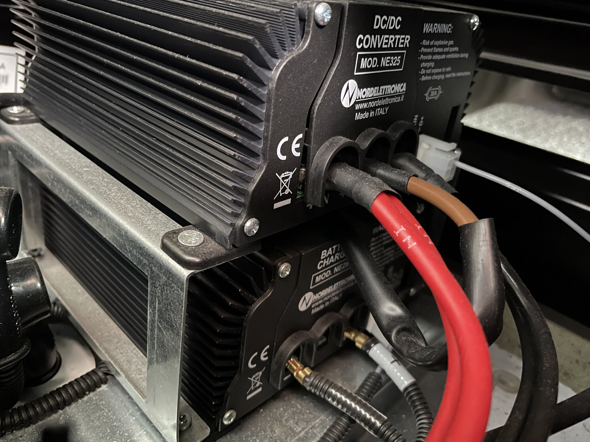

I have found the battery charger under the passenger seat. Does anyone know what I have to do to disable the charger so I can reconnect MH to mains power without powering up the leisure battery? I am assuming the solar panel is successfully ( and safely) charging the leisure battery.
The charger in your picture isn't the 230v mains charger, it's a DC to DC charger....only works when the engine is running and takes power from the alternator.
You will have a 230v charger somewhere.
If you have solar, then that will confuse things if you are looking at the battery voltage. The battery 'resting voltage', when it's not being charged and with no load on it, should be between 12.0V and 12.7V. You may have to wait until dark to check that, if you can't disconnect the solar. It may take some time (a couple of hours maybe) for the battery to settle to its resting voltage after being charged. If the battery voltage stays over 12.0V when there's nothing charging it, then at least you know it's not a shorted cell.
The battery charger is lurking under that DC-DC converter, not very visible, the model number isn't very visible either, probably an NE287, as rb62 suggested.
The mains charger is what the DC to DC charger s sitting on.
It is indeed a Nordelettronica NE287, not sure if 17 or 21 versions. Thanks rb62 for link to manual. The unit does seem to be a modern unit with appropriate charging profile for the battery.
I have disconnected the 230v feed kettle plug, and reconnected the mains EHU. I will keep an eye on battery temperature.
I will recheck battery voltage after dark but did this last night and expect voltage will be in 12 to 12.6v range. Is there anything else I can do diagnostically? We may be able to limp along without EHU charging of the leisure battery as long as solar panel and alternator charging are working, until we get back to North Devon or the main dealer in Weston.
Strange, I didn't even see that. :doh:
