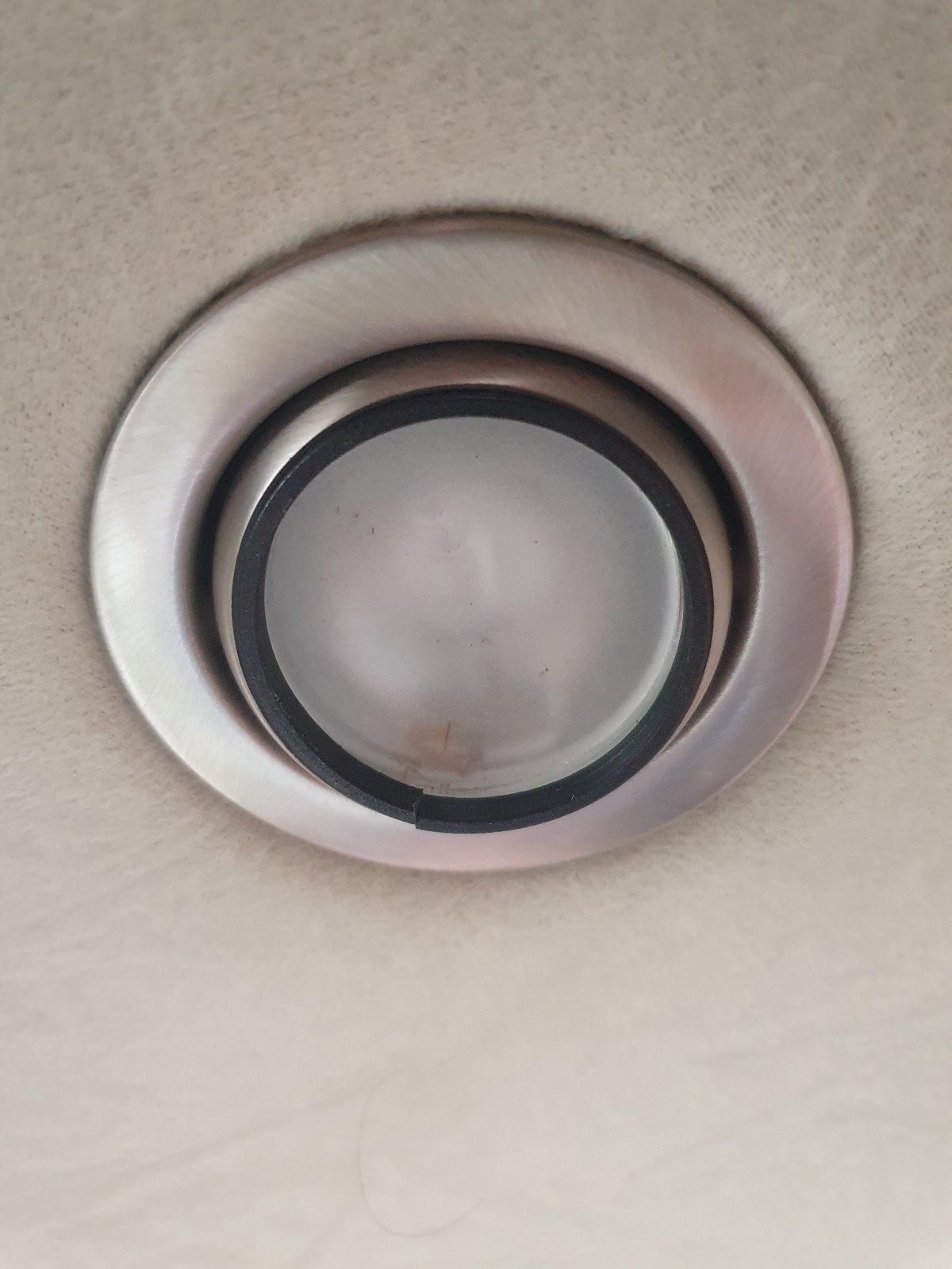

Update: I have bought some tiny MR11 LED bulbs, and fitted them and they are working absolutely fine.. pleased!
HOWEVER, I now find I also have some bulbs bigger than that, and I can't even get to them. And I am keen not to force anything, the van is an old lady now.
Here is a photo, does anyone know how to extract the bulbs? They are on a 2007 La Strada Regent L:

Looks like the black plastic ring is holding the glass in.

Peel out the black plastic ring, and then the glass will fall out, and scare you. 😲
