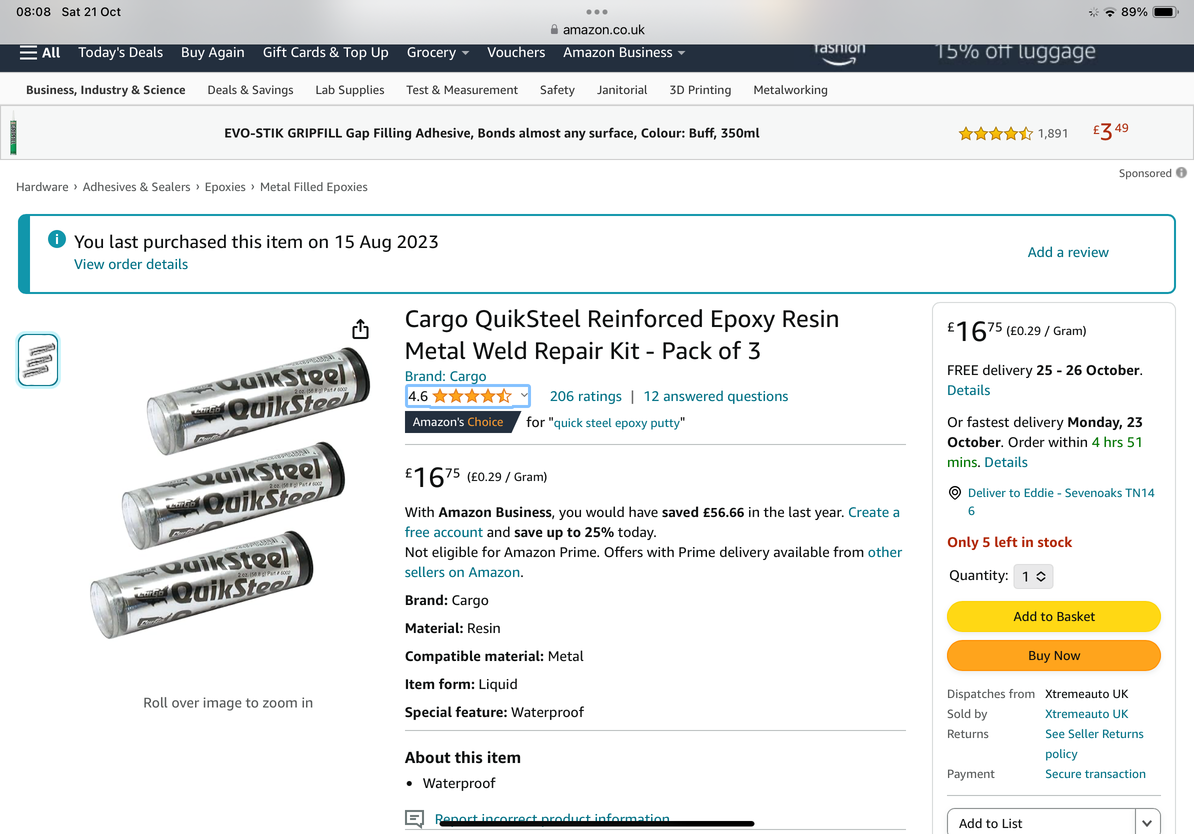

Always carry a stick of QuickSteel and a stick of WaterWeld in our van's spares box. (y)

See, now I blame you for awakening my mechanical, military mind and the need to carry everything required to effect a repair, you know, just in case. I was having epoxy envy at your WaterWeld, but for applications to the van and motor, the QuickSteel would suffice, BUT, what if I had a coolant hose fail 🙄🤷🏼‍♂️🤦🏼‍♂️

I think if it is metal and there is a hole, then the QuickSteel I mentioned above, should fix that no problem. Keep us updated and good luck 🤞🏻
