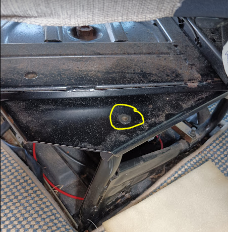

I have to change the leisure battery on my Knaus Sports Traveller. It is housed under the passenger seat.
I'm having a very hard time trying to access the battery. I need to remove the passenger seat but there are two nuts and bolts that are defeating me.
Here are some images:
There were two bolts on the front and I got them out fairly easily. The chair assembly swivels on top of that black plate.
This is a view from the rear of the seat:
There is a bolt with a flat head which looks like it will open with a six sided allen key.
and I used my phone's camera to see as best I could, the nut underneath:
Here are some of the photos:
I've tried a socket set and wrench, but I can't get a grip because there's so little room there.
I don't think the nut is welded to the frame either.
Does anyone know if I am getting something wrong here?
Surely there must be a way to access the leisure battery?
Any help or suggestions appreciated.
Thanks
Would it be possible to remove the seat base frame fixings to the floor and lift/tilt the complete seat/base to get access to the battery ?
On my seat base, I can only get to the bolts by sliding the seat back and forwards on the rails.

A friend came round with these tools:
and managed to open the bolt with one of these allen keys.
I've got access to the battery now:
