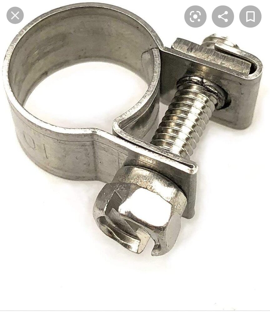

Use these:
https://rover.ebay.com/rover/1/710-...0001&campid=5338547443&icep_item=253802544449
Unlike worm-drive clips they don't have the flat area for the worm housing. They are easily fitted with wood-working pincers & removed with side cutters. They never leak or need re-tightening.
I would definitely agree with this post - much, much better than a cheap jubilee clip (y)
Due to the small molecule size of LPG its important to clip the hose. It will creep up the joint in time.
These work well on small hoses etc.
