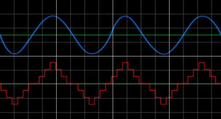

Just for those curious. Here is the difference between a pure sine wave and a modified sine wave.
The digital output has fewer steps and no smoothing. This causes harmonics amongst other things.
