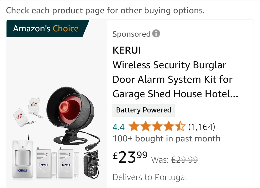

I've seen some posts on this topic, so thought I'd share my €30 solution (see Amazon advertisement)
A few years ago I bought a Kerui security alarm system on Amazon and installed it as described below, refer to photos.

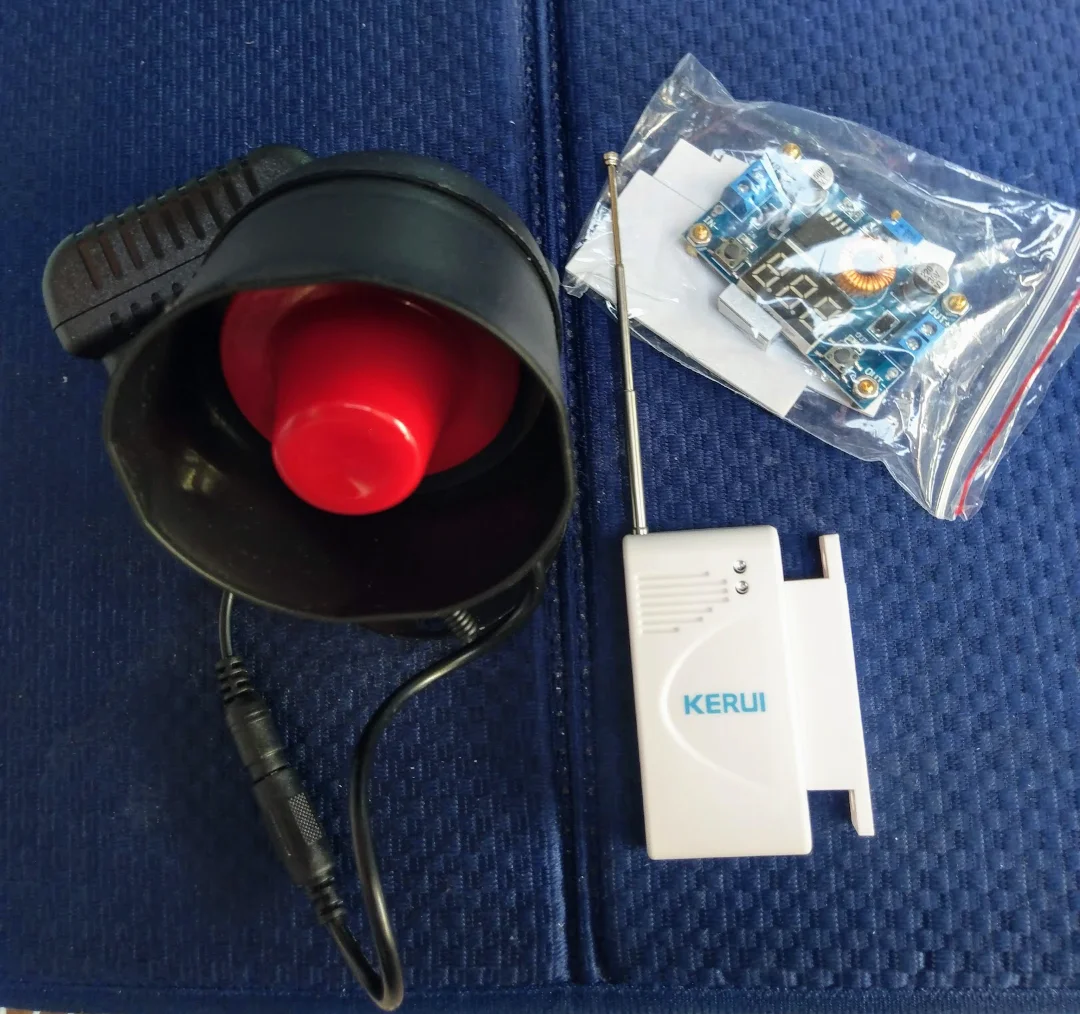

I installed the alarm siren inside the MH adjacent to the door opening side (see photo) and wired the alarm to the MH wiring inside the wardrobe behind the clothes 😂
This activates a 110 Decibel siren which is enough to do permanent hearing damage at such close range and makes it virtually impossible for anyone to enter the MH to do any looting, or search for the on-off switch unless wearing ear muffs!
A lot of security alarm installers mount the siren in the engine compartment which makes no sense to me at all, as we've all walked through a car park hearing an alarm, and nobody takes a blind bit of notice, whereas mounting the siren just inside the door prevents entry.
The alarm is activated by the Wireless Reed switch visible at the top of the door.
I also fitted Wireless reed switches to the garage and gas locker doors.

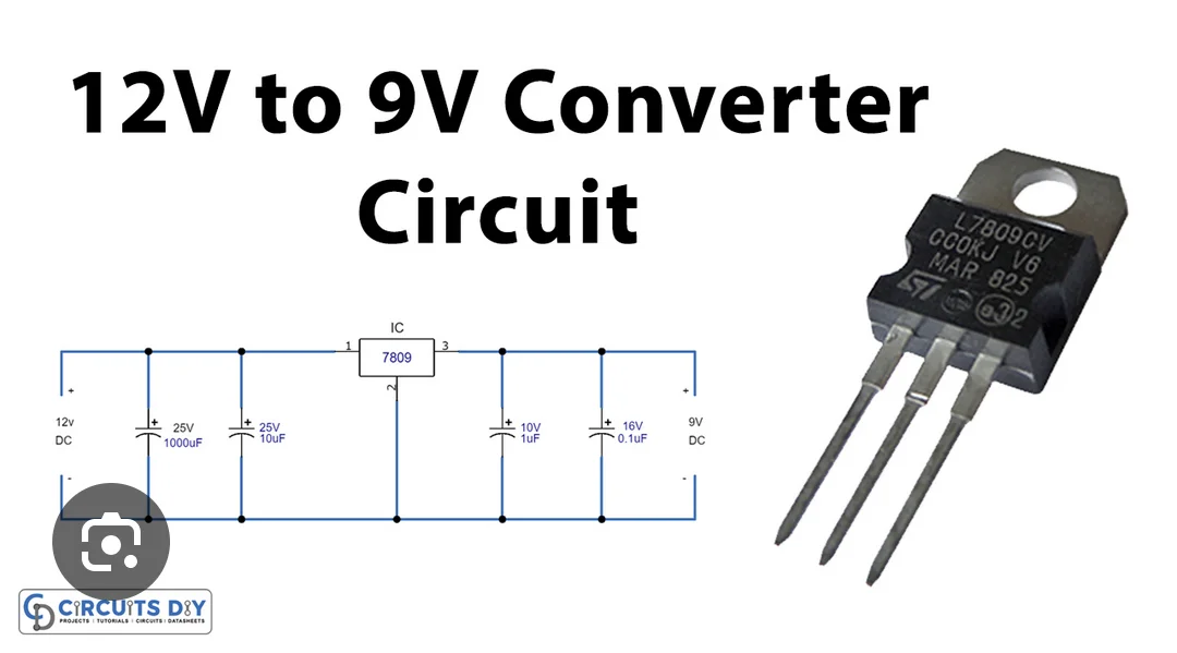

The simple solution I used was an NPN Transistor to change the 12V power to 9V.
The left pin is 12V in from the MH wiring, the middle pin is the earth/ground and the right pin is 9V out to power the alarm.
