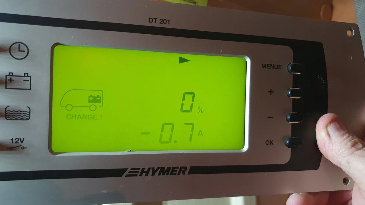

I don't know what is going on, but the 12 volt turned off last night.
It was a chilly night at about 3 degrees, but i survived!
Is there any way to reset the panel, or disable one of the functions.
i have tried to consult Apuljack, but they are shut down until 2nd January.
The panel has two functions to measure battery levels. The first is voltage, for leisure and engine battery. ie 12.5v snd 14v for example.
The second uses either a percentage or number of ah(amp hours?)
The second measure thinks that the leisure battery is flat, so it turns off the 12 volt supply.
No heating, pump, lighting or fridge.
We've tested the 12 volt cigarette socket , which says 12.5, same as the first reading.
I have just driven for 4 hours, snd the percentage went ftom 0 to 4%.
It also says that only about 2.5 to 2.5 amps are going into the leisure battery from engine running.

Thank you for the sympathy!! The leisure battery is 14 months old, and the reading was taken off a cigarette lighter socket that is in the habitation area. Definitely not off the engine.
Engine battery failed last winter in Spain, and was replaced.
Think I might have to tough it out until I get to the campsite on Saturday.
I am in a funster convoy!!!!
Sadly, none of us are electricians
As the control panel is on I don't think the Electroblock has shut down.
With the battery only taking a small charge with the engine running it does look like the battery has failed possibly a cell has gone high resistance.

The battery voltage doesn't necessarily reflect the state of charge / condition of the battery.
A dying battery can show a voltage in the 12.6-12.8v range implying that it's fully charged but actually only have a small percentage of its capacity left.
Sadly, despite not being all that old, my suspicion is that you have a dying / dead battery.
Until you can get it tested I would disconnect it and certainly not put any charge into it.

The EBL will turn off itmf the voltage drops to 10.5v, if the load is reduced on the battery the voltage will rise and the EBL will reconnect.
What is the total capacity of your leisure batteries? Is it a single battery, or more than one? If there is a question mark after the Ah capacity display then maybe it has lost the value of the battery capacity that was programmed in when the batteries were installed. You can set the 'nominal capacity' of your leisure batteries by pressing the 'Menue' button for three seconds. You simply enter the total capacity of your leisure batteries.
If it loses the settings, it probably reverts to the default value which is about 100Ah. If your actual battery capacity is more than that, for example two 100Ah batteries giving a total capacity of 200Ah, then when you have drained 100Ah out of them, down to the 50% level, the display will think you have taken 100Ah out of a 100Ah battery. So it will calculate that it is totally flat, and maybe switch the panel off.
Actually it's worse than that. If you enter the nominal battery capacity as 100Ah, the system will calculate 80% of that, and will show on the display that you only have 80Ah left. It keeps the 20% as a buffer to avoid totally flattening the battery and damaging it.
So it is important that you have the correct nominal battery capacity stored in the display, especially if your actual battery capacity is very different from the default 100Ah value.

Thank you, this worked to a point. My battery is 160ah, so I changed the nominal as suggested and it now things that there are 64ah available. Still git a question mark against it. Can't try a full reset until I have access to hook up.
But MY HEATING AND FRIDGE ARE WORKING. YIPPEE.

I spoke too soon. I only got 15 minutes on the Truma heating before it turned off again.
