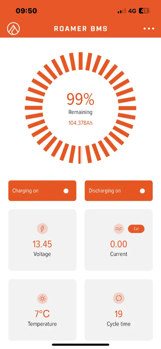

I have just been out and checked the Roamer battery voltage with a meter and also tried the BMS and it’s now woken up.
