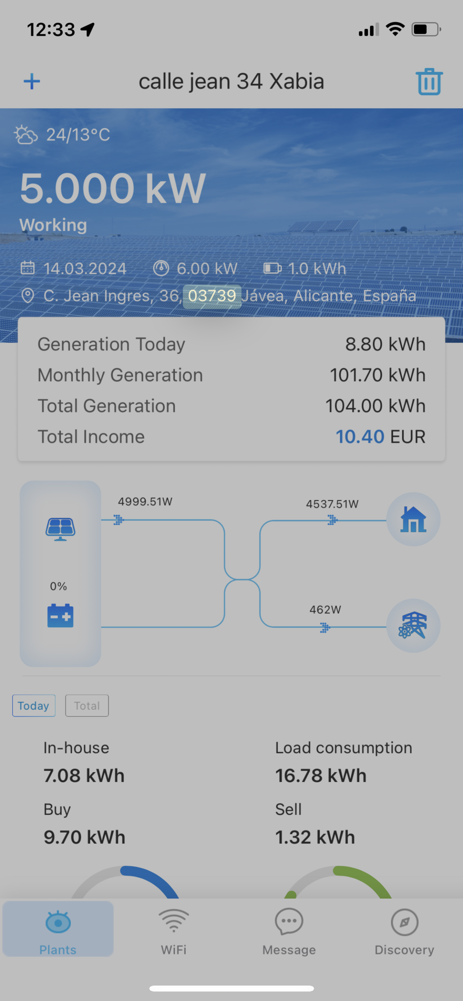

That is a system up and running , right?
If so add a 5kva mutiplus now £800-900, install ess, you are allowed to export excess, and a fogs tar battery. Forget about warranty. You will very likely not need it, just get them in UK, hook up the battery to the inverter, set it up, and test it. Then take a overnight train to Calais, and get it to Spain in you van; done it many times. Even two batteries at ones.
When you get to Spain, you will need a single circuit 16A breaker out of your consumer unit, hooked up at AC in to the multiplus. The ESS will provide power from battery, and will charge it when you have excess solar feom existing inverter. For that you will need a energy meter on AC side of existing inverter or on mains before to consumer unit. Victron does a nice meter now.
When you get to Spain, you will need a single circuit 16A breaker out of your consumer unit, hooked up at AC in to the multiplus. The ESS will provide power from battery, and will charge it when you have excess solar feom existing inverter. For that you will need an energy meter on AC side of existing inverter or on mains before to consumer unit. Victron does a nice meter now.
Yes it is.
I will try and digest what you are saying here.
Thanks for the input
