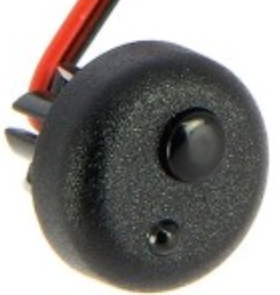

Is it a Cobra alarm? Do you have a small led push button like this one below?
If so, you turn the ignition ON, then OFF, and push continuously the small button until it flashes 1, 1-2, 1-2-3. Release the button and lock with the remote key. This way you've just disabled the interior sensors.
