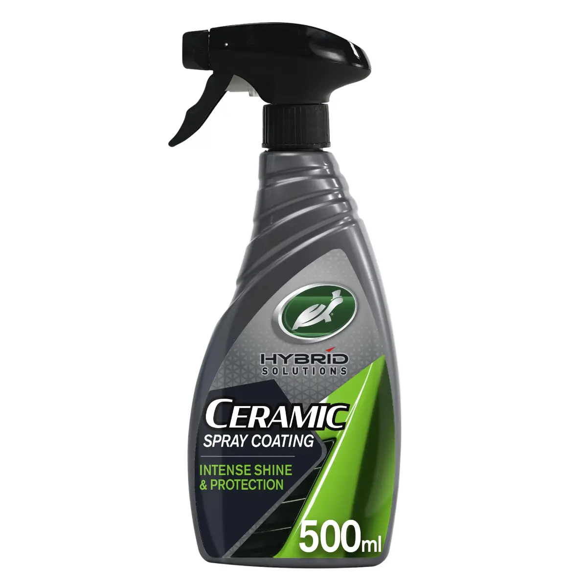

This stuff is ok, really easy to wipe on and off and lasts quite a while…
Bang on.I tested this on my daily driver for 6 months and now use it on all my vehicles.Needs reapplying occassionally but quick and easy and a fraction of the cost of ceramic coating
