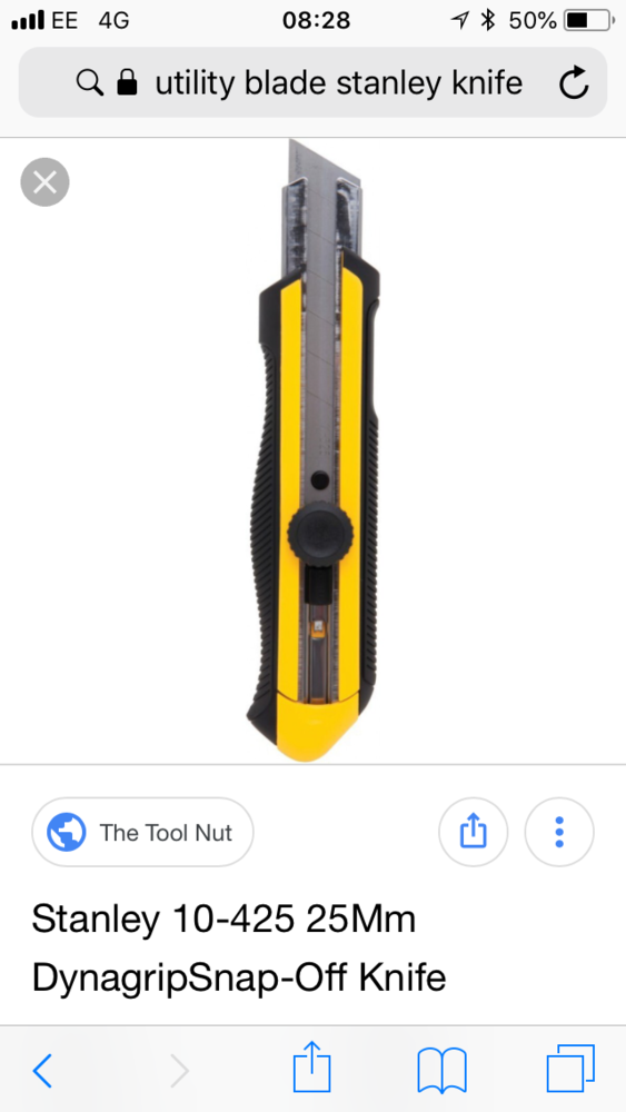

I did think about using a Stanley but thought I'd have to make so many small cuts it look like it was cut in half using a chisel - didn't think about one of those long-bladed Stanley's.
I might try the serrated bread knife first and if no luck then I'll try the long Stanley.

electric bread knife, but can also use a sharp bread knife .. a Stanley blade is too short to give a nice clean cut
