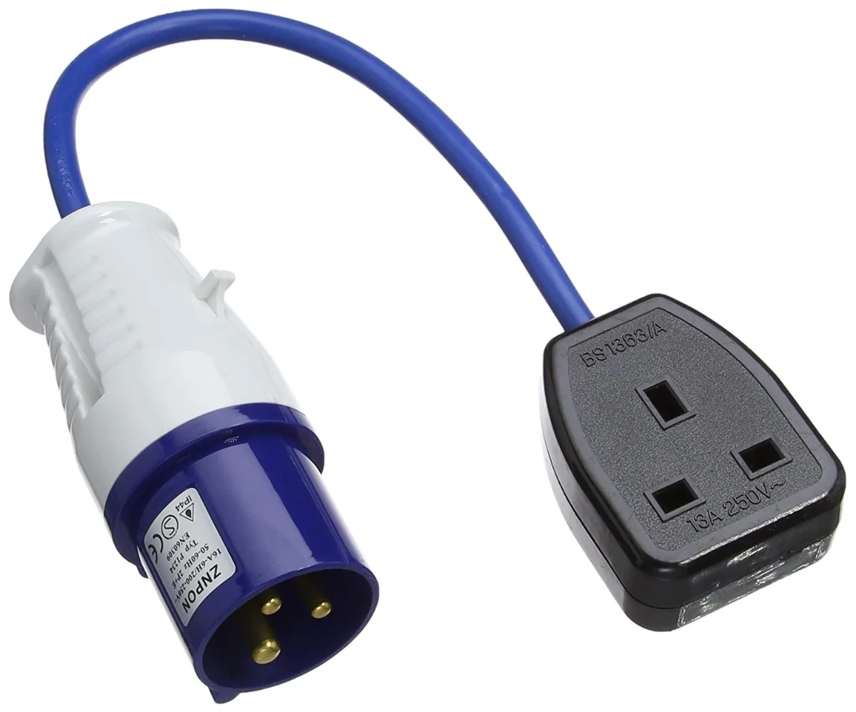

The first thing to find out is if the 240V mains supply is reaching your van. There should be some 13A 3-pin mains sockets somewhere in the van. Can you plug something into one of those to see if the socket is working?
I have one of these socket testers, simple and cheap, from any DIY store. They show if everything is OK, and they also show up dangerous faults like missing earth wire too.
I also have an adapter from a round blue 16A plug to a standard 13A socket, like this:
I plug the socket tester into the 13A socket of the adapter, and use this to test the site hookup post if it's the round blue 16A type. I can also plug it into the end of the hookup cable to test the cable.
