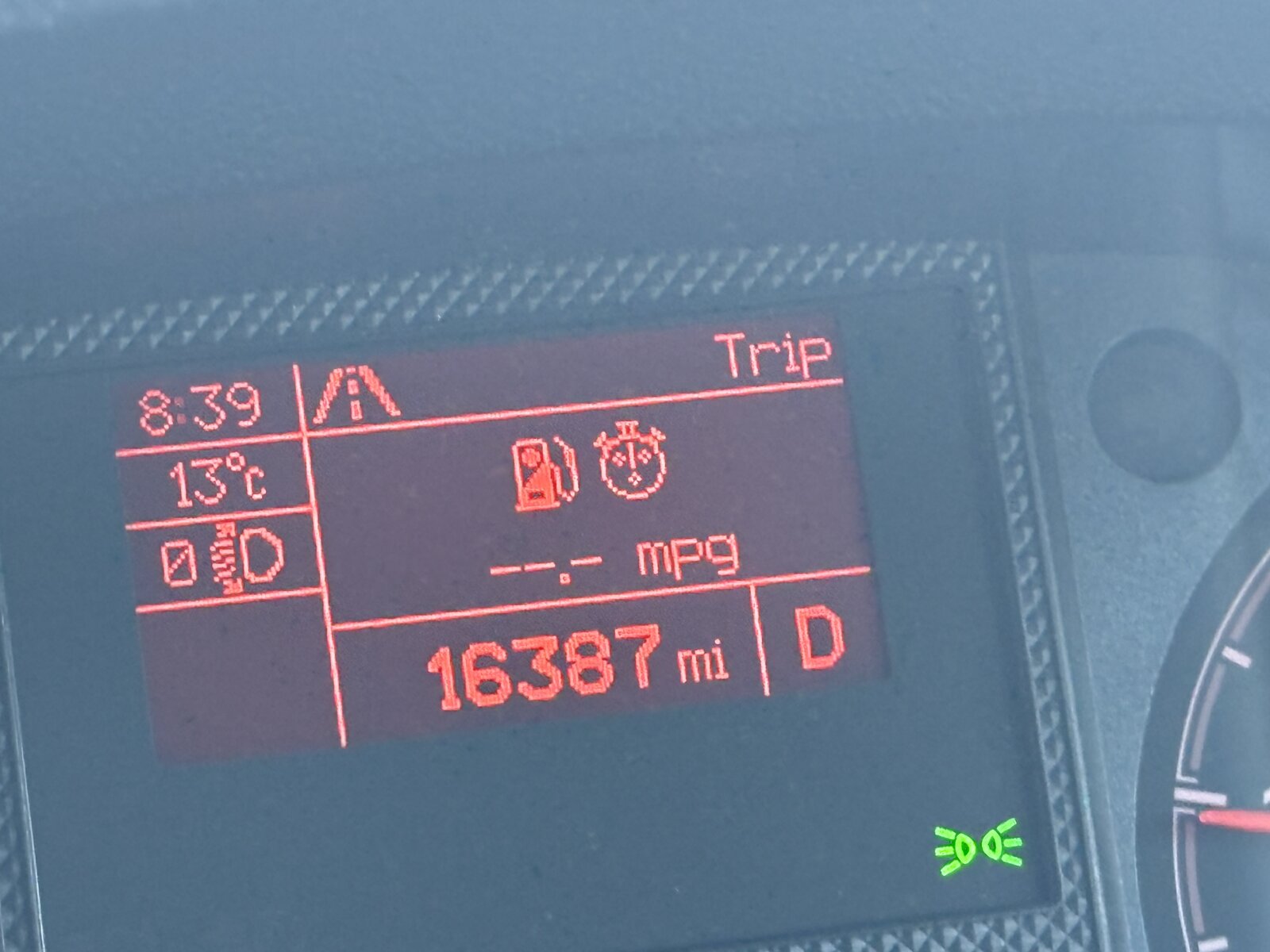

Hi, we have a symbol appear on our dashboard just next to the petrol pump indicator. Any ideas what it is?

Looks like a stop watch but no idea what it's for....sorry. I guess it might be time to refuel

There is a slightly inconclusive discussion on the Fiat Ducato forum here
The suggestion is:
"Combining that and the pictures in the other thread referenced, I'd interpret that as the trip computer showing average MPG since trip reset (the stopwatch representing the latter).
It should be easy to check by changing the trip to display some other value (I'm not sure how that's done on the later models as the manual doesn't mention the button on the end of the RH stalk, and implies one might have to resort to the "Mode" button and underlying menus. There again, my manual doesn't mention the stalk button, but it is there and works)."
Cheers
After all that it just means it is still calculating the mpg and range stuff as there is no mpg to work with yet. Drive a few miles and it should disappear
We have the same style dashboard display in our 2013 van. It's not a warning light as such - that central area of the screen is the 'trip computer' and you can cycle through various modes with the button on the end of one of the stalks (right side? I can't quite remember without being in the van!)
There are various different pieces of information it will read out, pressing the button cycles onto the next piece of information. Current MPG, Average MPG, distance until fuel empty, current date/time, etc.
I'm 99% sure that the combination of symbols you see there mean "average MPG" as per the last post - if this looks "new" to you then perhaps you've inadvertently changed from displaying a different mode in the past, by knocking the button on the end of the stalk?
But as it's not a warning symbol, it's nothing to worry about :)
