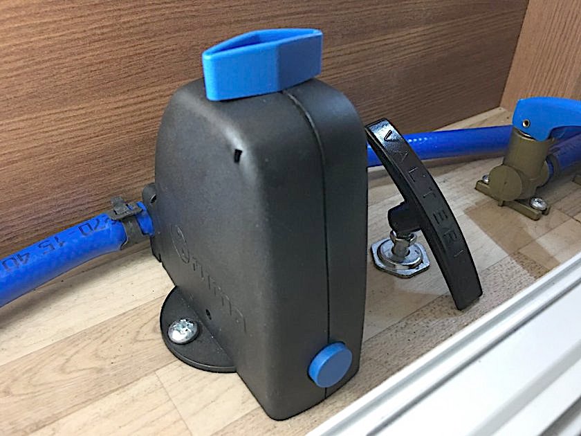

Frost stat tends to look like this and is often nearby the boiler so heating the boiler first can allow you to reset the stat.
Press blue button to reset

Thank you all, we have tried the heating for 2 hours and also putting the water heater on but the blue button kept popping out therefore i wondered where the sensor was.
Did you twist the blue lever then press the button to reset it? Daft question, I know but all I could think of. It caught me out the first time.
Edit - I don’t think that there is an external sensor. what you see is it........
Thanks DuxDeluxe, yep have tried the twist but button just pops out again.
It should click and stay 90° and the button should stay in. Have you tried warming a cloth or something and placing it over the unit for a while Then try resetting? That is a very long shot.........
sadly it looks like the unit may have had a spring failure or similar
As a Jury rig, provided your van is already warmed, can you wedge the blue button in with a piece of wood or something similar to hold it there?
mine is the same as the one in the picture and I put a blue tie round it
If you put the Truma Blue Frost Control Dump Valve in your house freezer in the set position after a few minutes it will clunk and go to the dump water position. You cannot reset it until it warms up to over 3C approx.
{ I did this experiment out of curiosity }
The earlier version that people disable with a clothes peg requires 12V to make it work.
The SET position of the Blue Truma Frost Control valve is the Blue plastic Toggle 90 degrees to the main body with the blue button pressed IN.
The 'Dump water position' is the Blue toggle in line with the main body and the blue button 'popped out'.
I have been told that there is a bi-metalic strip inside the unit that senses the temperature.
