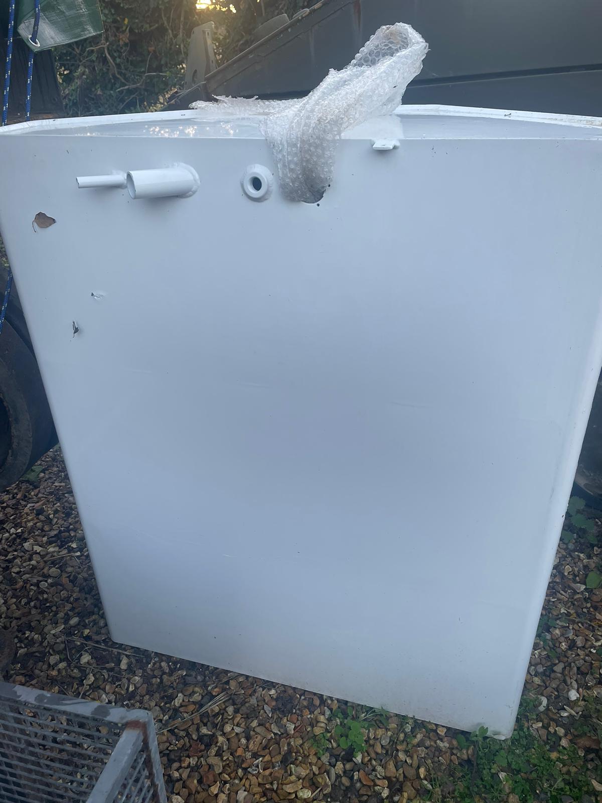

We can make a tank to fit under and feed the small tank this one is 200 liters
Would need to check the weights this one is for a tag axle one so the weight isn’t a problem
