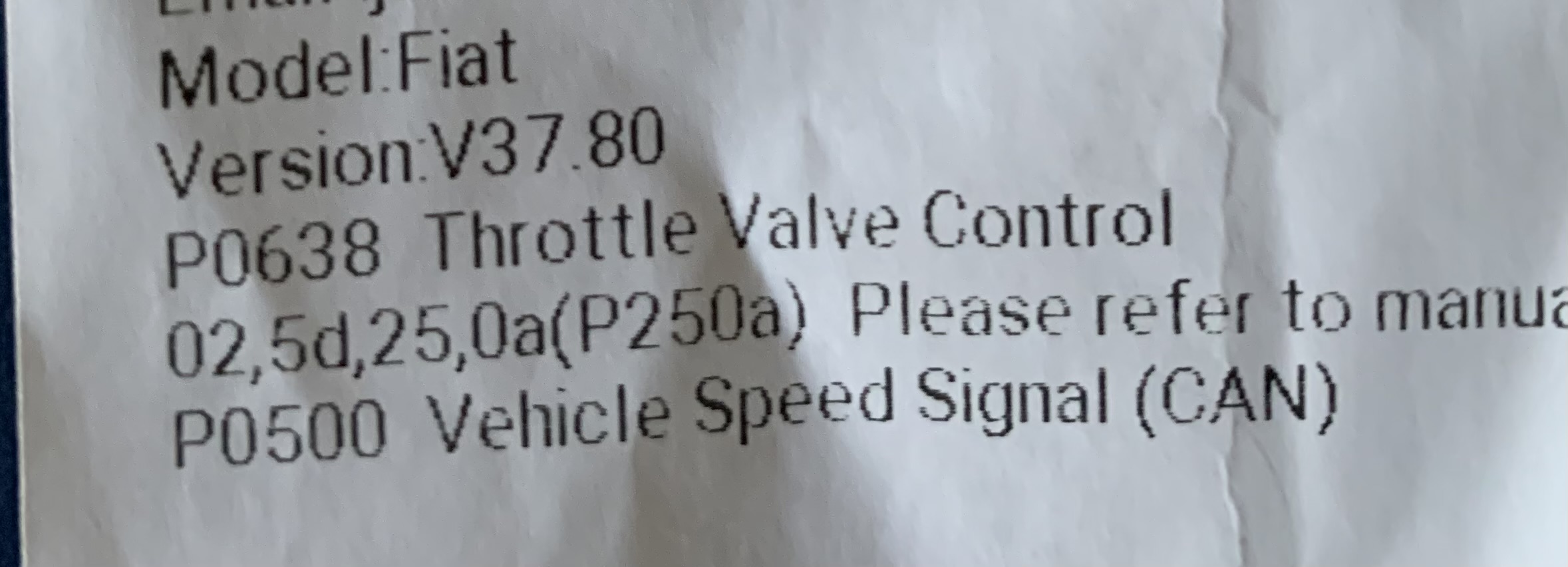

Had the engine management Light come up as we started the our motorhome to come home last weekend, luckily we were not too from home. Had a mate scan it and it came up with P0638 code we cleared it but after a few minutes it came back on again.
Just changed the throttle control body as it was pointing to that.
Annoyingly the engine management light is still on and strangely the scanner says “ fault cleared but is still present “
It’s just weird that we could clear the fault code so the light went off even though it came back on a few minutes later but now it’s just on continuously.
Any ideas ?

I totally agree, that’s the thing with scanners they only point you in the general direction. It isn’t even a cheap scanner my mate has got it’s a £2500 Launch. We were able to do a few live data tests but we are still scratching our heads

Yes Andy the fault code was originally clearing but reappeared after a few minutes but now it won’t clear at all. All we have done is fit a brand new genuine throttle body.
If I put my foot flat down on the throttle it’s revs to 3500 then drops to 3250 and stays there
