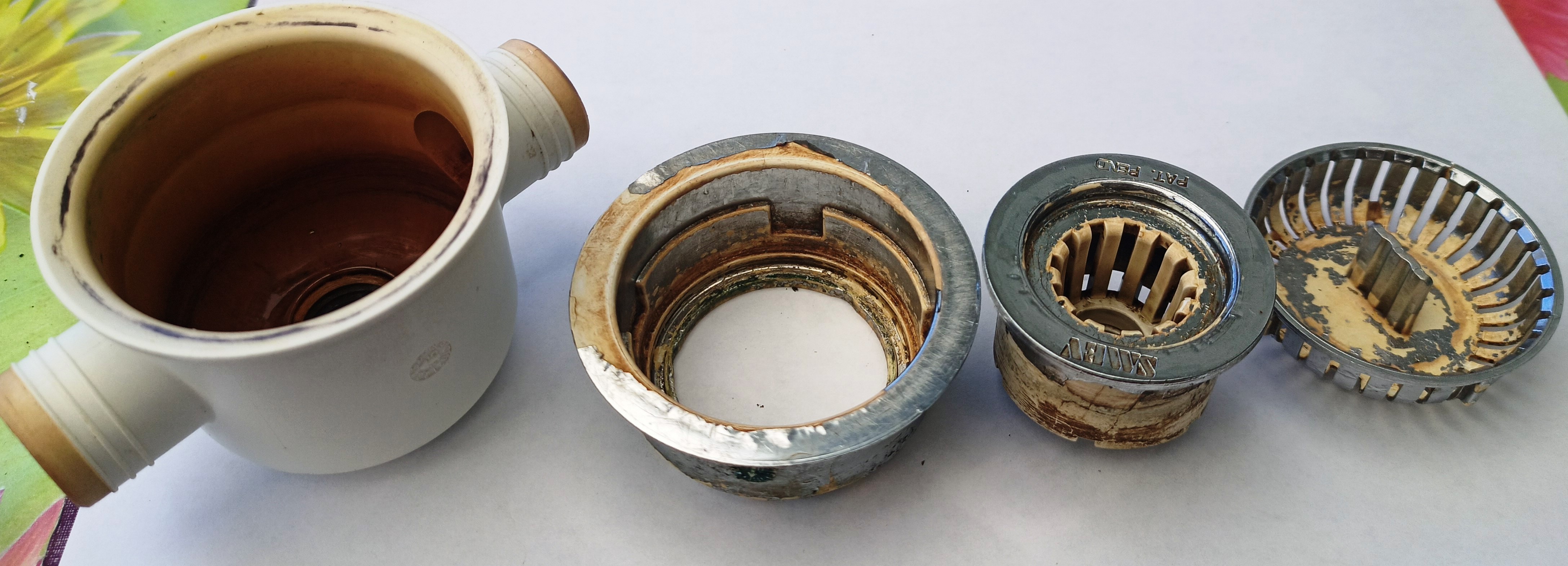

Thank you, I know this item has been looked at before. I have removed the whole unit, which is easy, but had difficulty locating a better fitting unit. Mine is cracked but serviceable. I truly wonder why they used such a feeble overpriced difficult to clean unit for so long.
I could make a conventional sink plug for it. Has anyone got a picture of the drain with the basket removed
I think I put one on the original thread about it, I can do another one later.
The whole thing needs replacing all the chrome flakes off.

Yep, it's total garbage, while I had it out removed the flaky chrome from the top lip and then smoothed it with fine wet & dry, it looks much better in white.

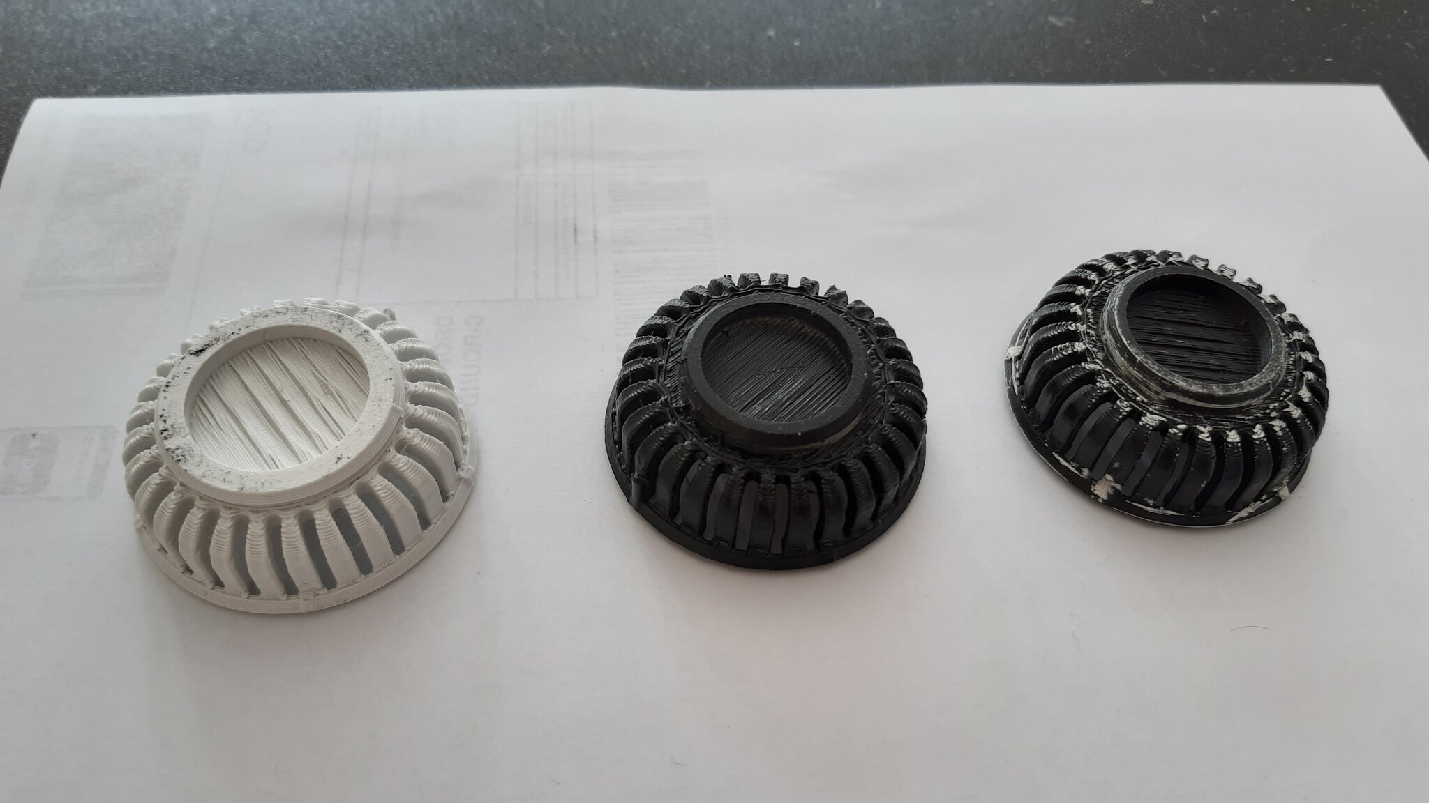

My nephew is a bit of a geek and had a go. None of them fitted properly, he couldn't get the part where the rubber o ring sits just right. They do feel as strong as the original. When mine breaks ill fit a new trap and strainer. We have taken to using a basin in the sink. It saves on water too.
