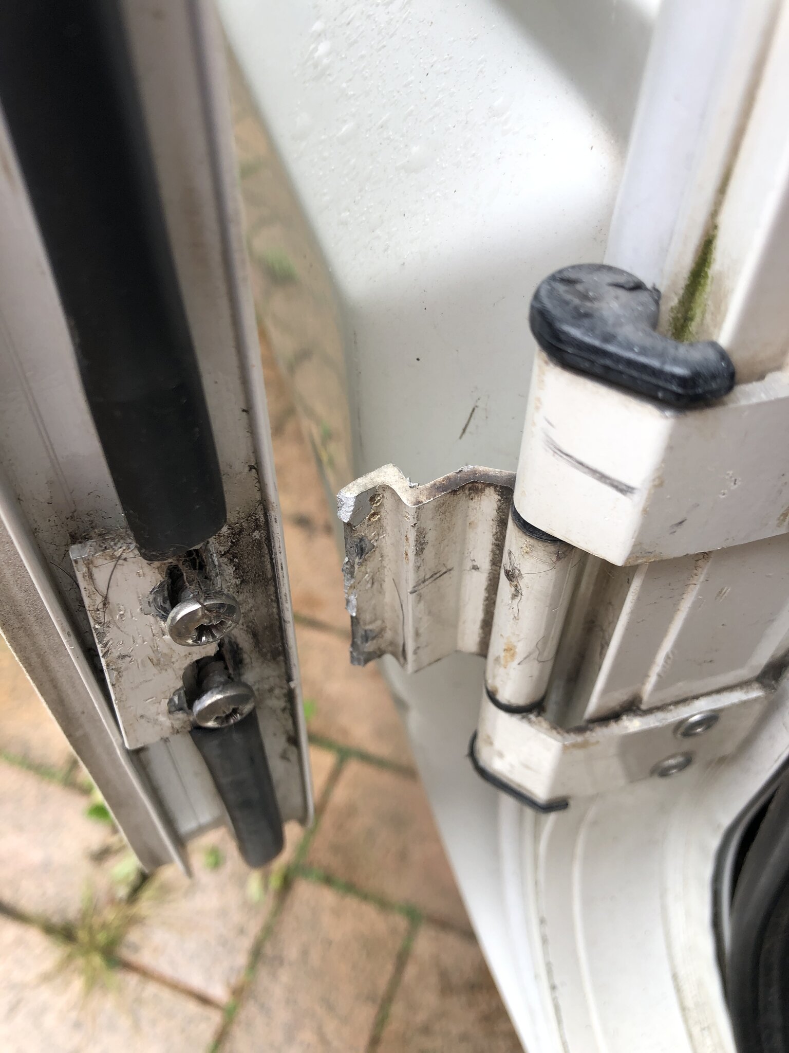

Has anyone managed to source a replacement hinge like this?

Pic of the complete door will help as it might identify the manufacturer. A lot are made by Hartal. A few on eBay. Also search dometic caravan door hinge.

Is it this one.
also.. look at this thread .. https://wildcamping.co.uk/threads/ellbee-white-triple-section-door-hinges.83218/
Thanks for that!
I looked at the OLeary one but the measurements are wrong by 10mm - although it does depend on what they are measuring…..
I might drop Billsunhinged an email 👍

Try an engineering place they may be able to weld it back together if you can get it off.

I have emailed Billsunhinged ( love that name 😂) and will await his reply.
O’Leary’s seem to have second-hand ones in stock @ £29.99 plus £9.99 postage. Hmmmm… 😔

I have had a very speedy reply from Billsunhinged as follows:
Hi Janine yes these have not been made for 15 years I’m only person making them supplying Motorhome dealers their £45 each handy fix kit rivits and silicone grease £1.50p each 1xp/p uk £6 their aluminium colour only don’t use oil or wd no good for bush’s.white T bar door retainers hold door back £3.50p each spare black hinge end caps keep weather from pin pk8£10 I also do new gas locker hinges also obsolete set top and bottom £90 single £45 fix kit £1.50p I post Royal Mail first class signed for and send Royal Mail ref number these are banktransfer prices PayPal costs more I will send you pictures hope I can help thanks
Regards
Bill
I am thinking that a new one from him is better value than a second-hand one that might already be fragile along that bend.

I fitted a new hinge from Billsunhinged a few months ago on my sisters Eldis.
Very quick delivery and easy job.

Ordered from Billsunhinged on Tuesday evening and it arrived this morning - which was a surprise as it was sent via Royal Mail (who put it through the letterbox despite it supposed to be signed for)
Just got to get my son to shoe-horn the fitting into his very busy schedule 😏😂
