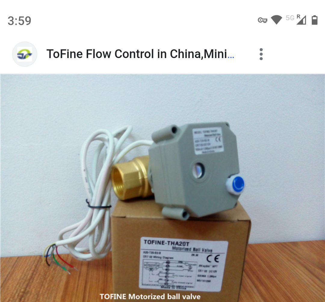

Does it look like the one in the image below? If it does, the small blue knob is a manual override. Just twist to manually open or close your valve, until you get a replacement.
Yes. It looks just like that but with a white button. I have tried turning the little button about 3 turns anticlockwise ( very awkward, and stiff ) but there is no sign it is opening at all ?
Is that the right direction ?
The should be a little clear window with a fine red line showing how open/closed the valve is. Turn the knob and see which way the red line turns. That'll give you an idea of where you are in terms of how much to open or close it. It takes about four or five full turns to open, I think from memory.
This bit here.
Hi Dave. Thank you. Managed to use a mirror to see indicator window, but after at least a dozen turns in each direction the line didn't move. Is the ToFine THA20T ball valve the only option or is there a high quality replacement that has proven to be more reliable ? Many thanks Chris
I did a few hours searching and found, I think, that all of the ball valves are made in China. Mine is the same as fitted to Hymer, Dethleffs, Rapido and some UK made vans. It came with a German GMBH sticker added. I suppose like most things there are good and bad Chinese made alternatives. I couldn't determine the difference between my German stickered one and a Chinese one I bought for around £14. Compared to £280 for a stickered one from a dealer.
What I did find out was that the control mechanism is the same, it's just the valve under it that changes in diameter. If you get the same type/shape of valve. So if the electric part is faulty, there are a few that fit using the four bolts, onto your valve if it's still working ok. What you do have to be careful with is the voltage and wiring options. There are multiple voltage types and the wiring can be different dependent upon if you want led warning lights telling you when the valve is open or closed.
