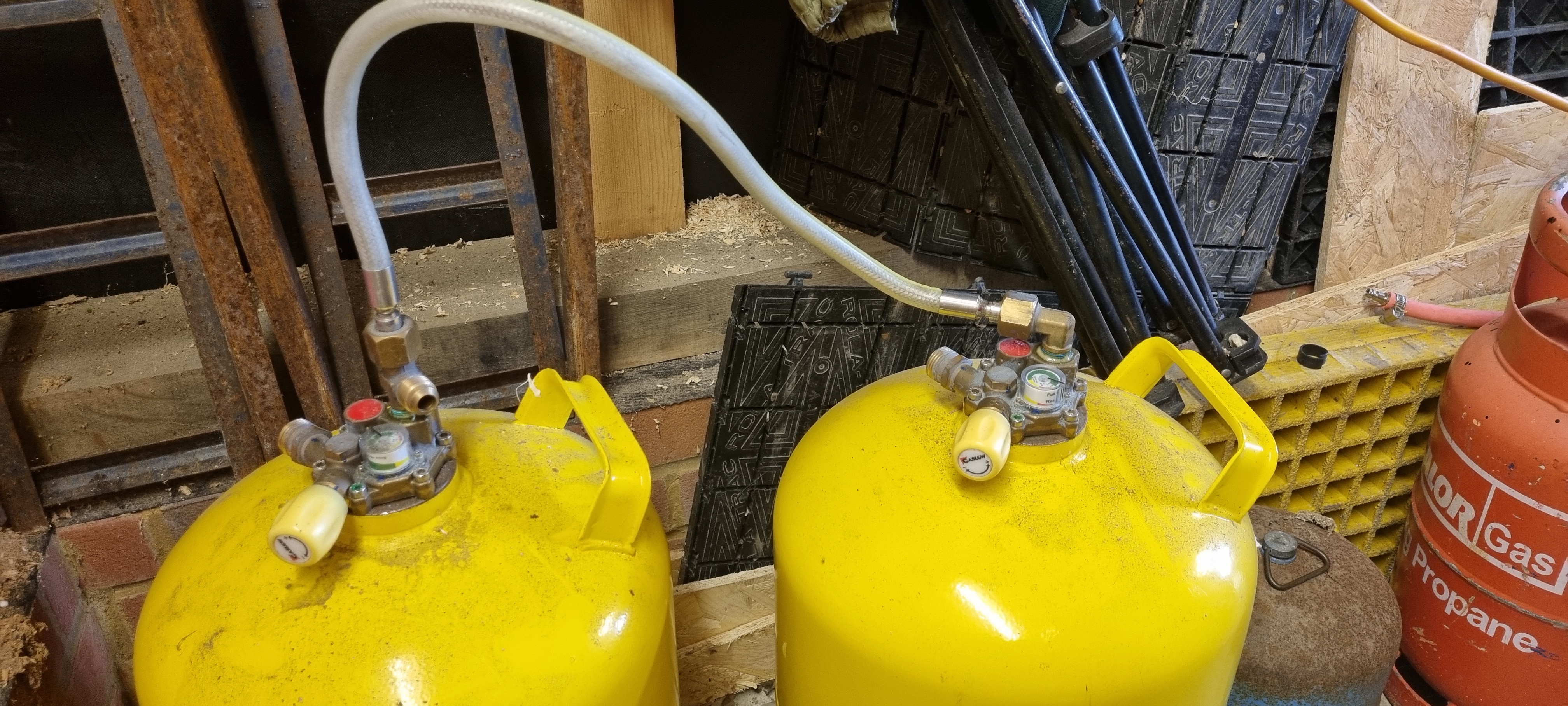

I took my Gaslow cylinders out of my last m/h to put in the new one. All the filling hoses and regulators will be new so I want to replace the connecting hose as well. I'm not sure if its clockwise or anticlockwise to undo each end. I've tried pretty hard in both directions but as both cylinders are full, want to do it right when I up the anti. Can anyone confirm
please?
If the nut is slotted around it and not plain. Then it is the other way round to normal. Standard for gas connections, I believe
I took my Gaslow cylinders out of my last m/h to put in the new one. All the filling hoses and regulators will be new so I want to replace the connecting hose as well. I'm not sure if its clockwise or anticlockwise to undo each end. I've tried pretty hard in both directions but as both cylinders are full, want to do it right when I up the anti. Can anyone confirmView attachment 755622 please?

I’ve just swapped a system. The fill pipes are standard ‘righty-tighty, lefty loosey’
