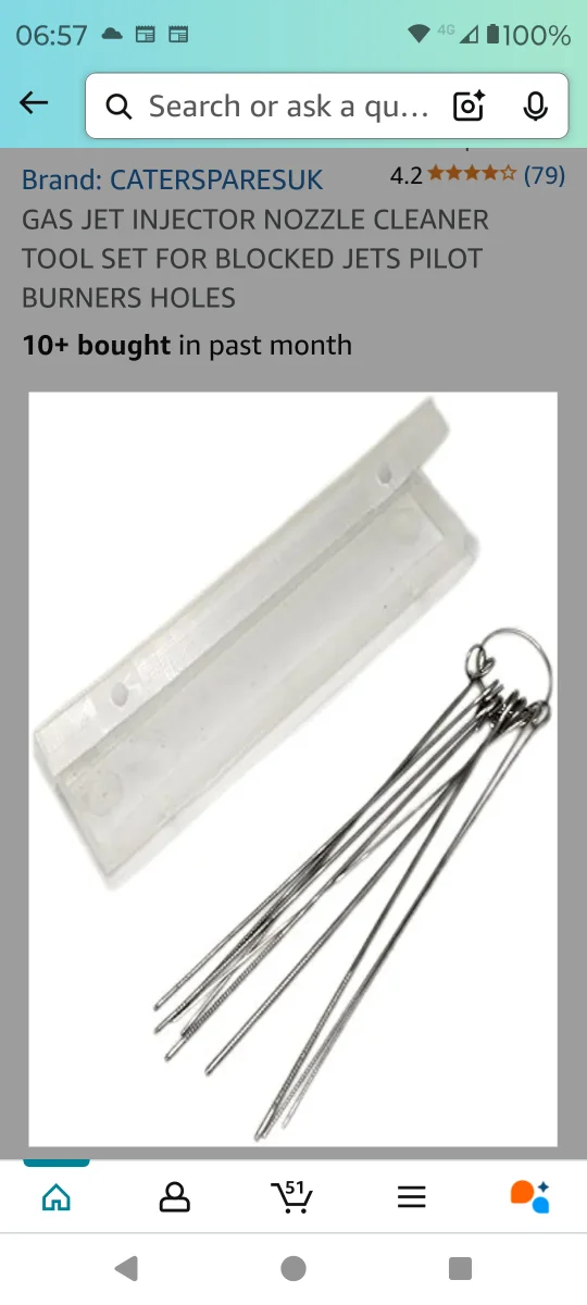

Remove the jets and use compressed air or a proper tool to clean them. Can't use any old piece of wire I was told ..

The best thing to use is fuse wire, it's tough enough to clean the jet but soft enough not to damage it. I thread it though the injector and hold one end in my teeth then run the injector up and down and spin it round. That way any dirt will be moved.
