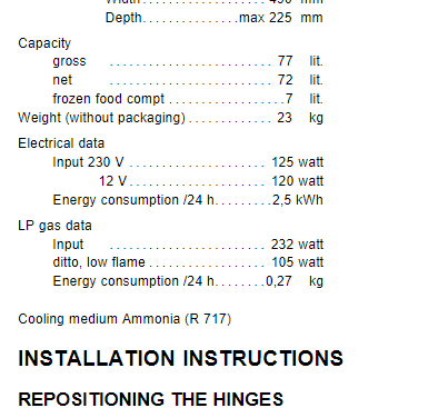

This is all that the User Manual says for gas consumption............ 0.27kg per 24hrs.
The spec'n below says that on 12v it takes 120W (10 amps) so a 120Ah wet battery might run it (only the fridge) for around 6 hours as you will only get useful voltage down to around 50% of its declared capacity.
