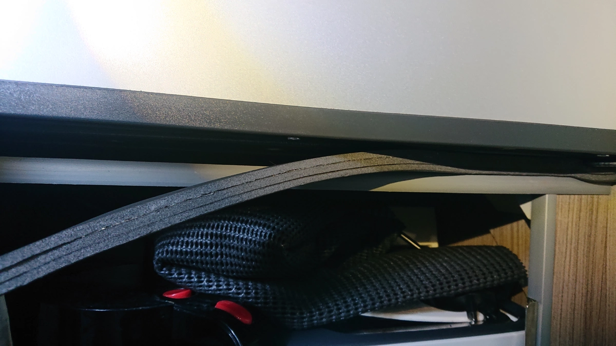

I used some 3mm adhesive closed cell foam / neoprene.
This was between the fridge base and the lower cupboard; I used 3 strips stuck together and just wedged it in:

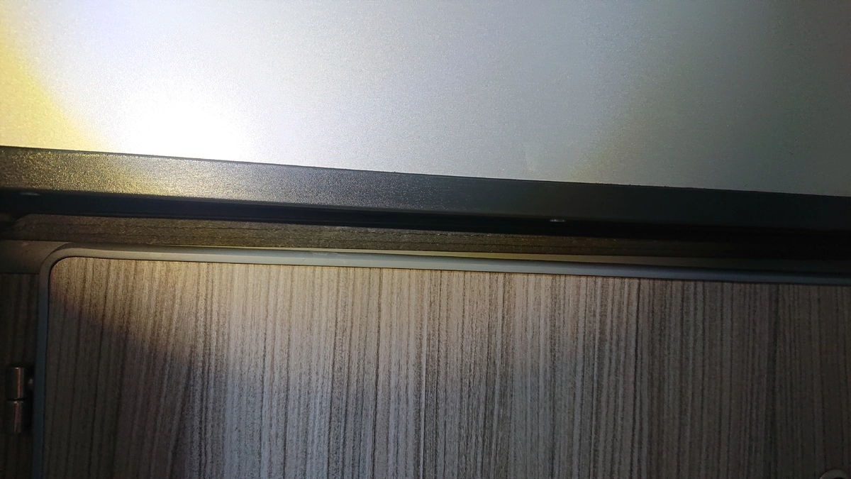

Above the fridge was a bit trickier, because the drawer is directly above.
So, I removed the drawer (not so easy!!!), and placed some of the 3mm on the BACK of top of the frame of the fridge, but not all the way across, essentially avoiding the drawer sides, as below:
Then, (not got a picture of this), I put shorter bits and placed them on the bottom of the drawer towards the FRONT, so that it overlaps, and blocks the gaps. So, essentially covering these gaps:

The fridge vents make a big difference in the winter, and this foam does essentially the same the rest of the year. There is now (almost) no draught even in very strong wind; the only place we still get a draught in storm / gale force winds is through the seat belt gap above the fridge, if it is really bad I stuff a tea-towel or bar-towel in there!
