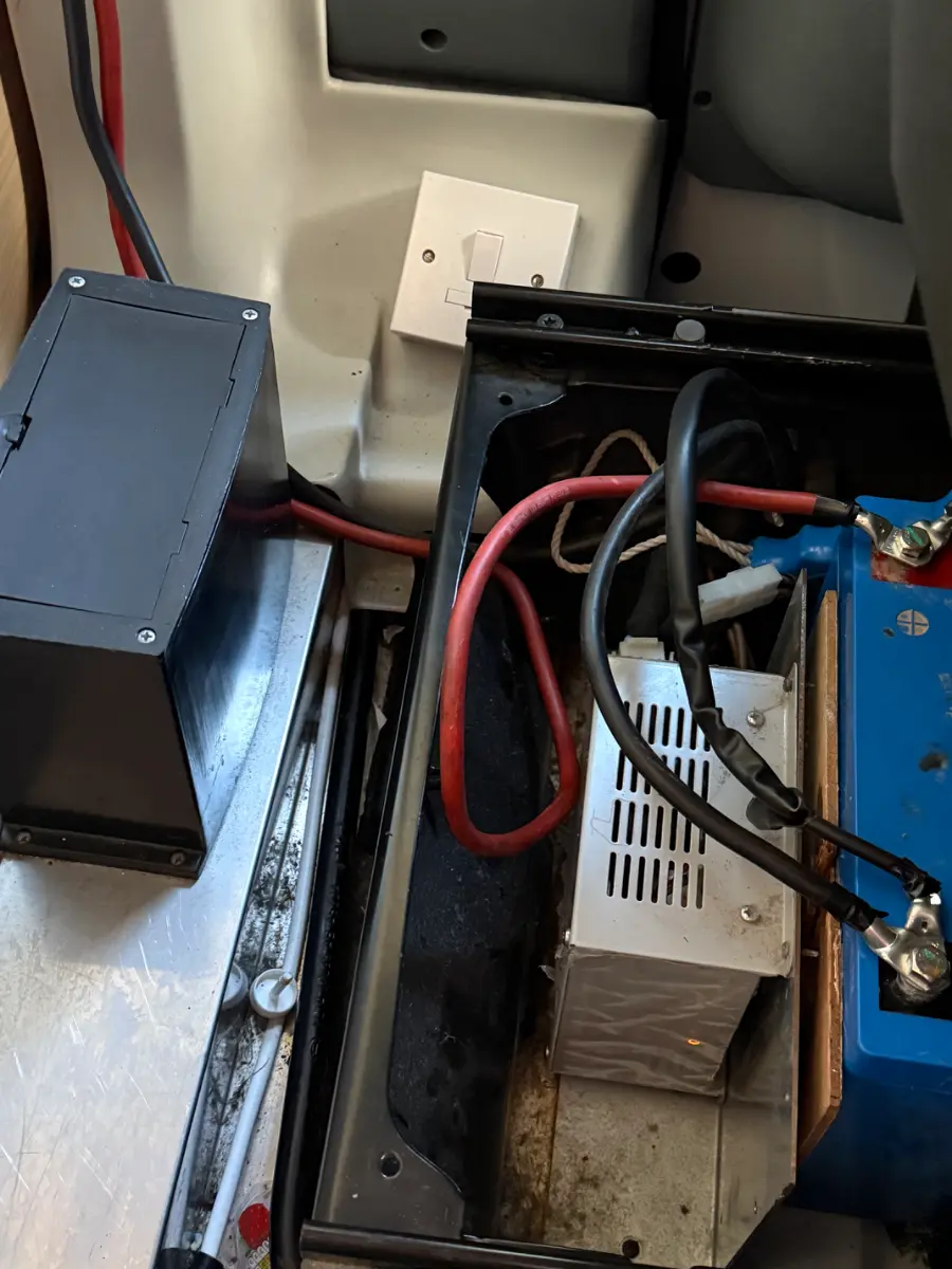

Hello does anyone have the original hand books for like a 2008 ford just purchased mine and dont really understand what everything does i have a white switch near passenger seat etc just want to understand how it works

Again something none standard, my guess would be it switches the battery charger on and off. Mine came with battery charger permanent on and have added a switch. If you switch it on and off you should see the mains hookup light (8) on and off on the control panel above door. Also pressing the battery switch should show the hab battery flashing across to show when charging on hook up

The box attached to the habitation battery is the battery charger (actually a 13.5v power supply) it's the only 240 item around that part of the van, hence my guess about the switch. I've moved mine above the black fuse box behind the seat. All the fuses in that black box are on the 12v system. I moved it so I could fit 2 110amp h leisure batteries under the seat. I'm assuming the red and black wires leading up the bulkhead are either to a solar charger or an inverter.
