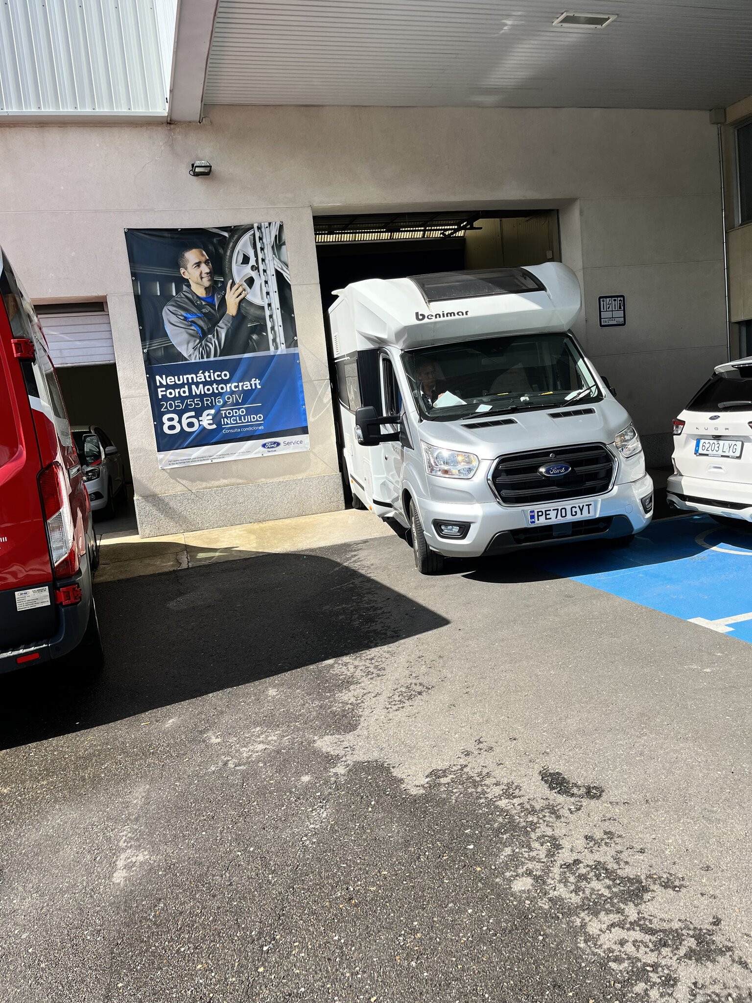

Yes, bad batch of fuel injectors that kept failing, it was from approx 2017. - 2020.
It’s now been corrected however there’s no telling when they will fail if it’s the bad batch.
Example - this year in may iur 2020, 3000ml injectors went!!!
Very frightening experience in Spain, van got taken back to Salamanca and spent 5 days in garage !!
We were put up in good hotel and Ford paid 2k bill - comfort ins very good thou .
But in a rush they nearly damaged van !
It was all a nitemare tbh but we must say our Ford is brilliant and pulls n runs a dream would purchase another Ford 👍

View attachment 817196 View attachment 817197
What a nightmare! The faulty fuel injectors were fitted 2019/ 2020. Mine was earlier than that as a 68 plate so not the faulty batch but due to water ingress. Fortunately my injector went a mile from home. Let’s all share photos of our fords on flat bed trucks 😂
