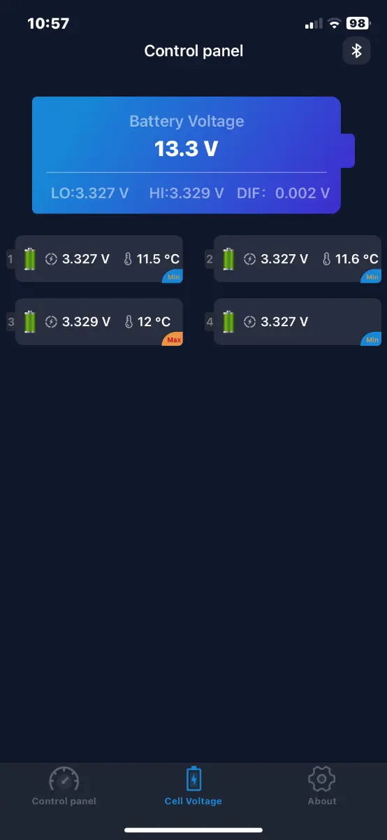

I just bought The Beast 608ah battery and in the app you can see the individual cell voltages and temperatures.
Well I can for 3 of them…… cell 4 shows the volts but not the temperature? Is this normal or is there a slight fault?
That is normal with the Fogstar BMS, both mine just show the temps for 1 & 2.
If I remember correctly the jbd BMS has 3 temp sensors 2 on the battery and one internal so they are not cell temps all 3 can be turned on/off in the overkill solar App,wich I prefer to the fogstar app or the carplounge app
