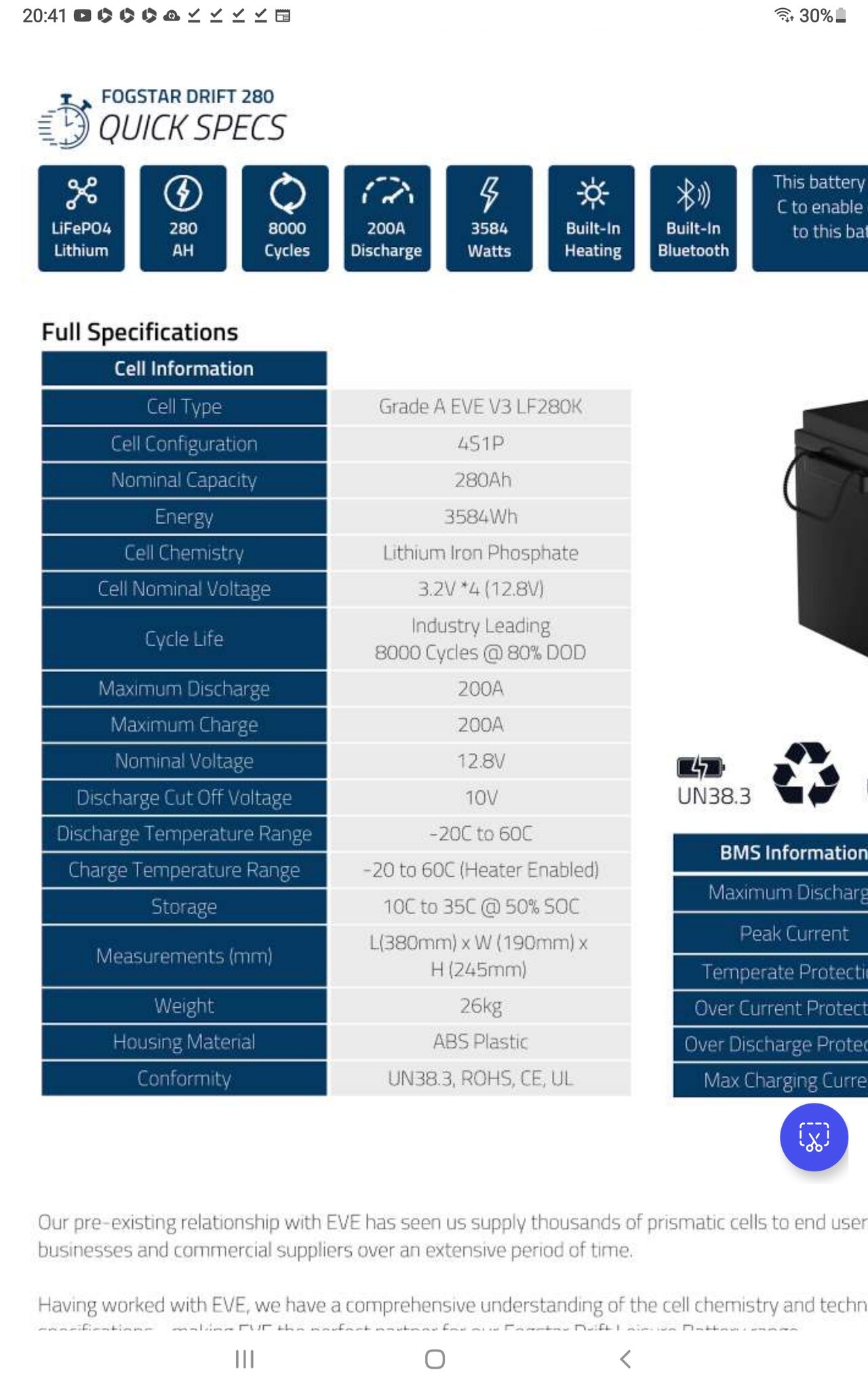

Can anyone advise if there is a difference in quality on the fogstar drift 300 v 280. The spec sheets below give rhe 280 8000 cycles at 80% v 4500 cycles on the 300, or am I reading it wrong?

My reason in going for the 280 was the difference in price. The 300 just wasn't worth the extra.
The difference in cycles is probably negligible to most.Usually one is available when the other isn't.Just buy one, any one 😀
I did check that with them, they confirmed it wasn't a mis print, the 280 is different cells.
I too went for the 280Ah. I was unlikely to need the extra 7% capacity. And it cost a lot more then 7% more. And appeared to have worse longevity.

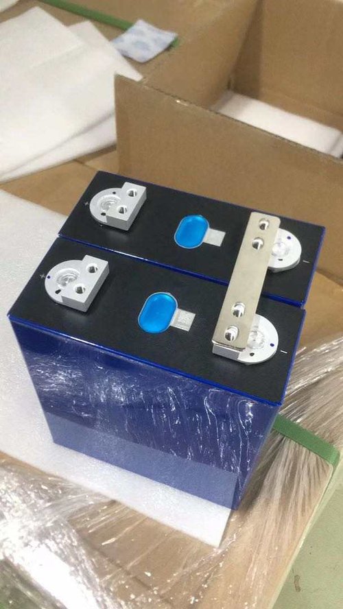

For some time the Eve 280 cells have had the improved terminals that significantly extend the number of cycles. They look like this
There is a bit of flex in the terminals and when the cells expand and contract the internal stress is decreased.
Up until a few months ago the 304ah cells looked like this
Not as flexible resulting in more stress as the cells expanded and contracted.
In addition to the changes (improvements) to the terminals the new busbars that work with the new terminals have also been improved, instead of being stiff and rigid they now consist of multiple thin layers of metal and the result is a much more flexible bar. Even less stress on the terminals.
For some time the 304’s used the old style.
But for the last few months both our 304’s and 280’s have been based on the new improved terminals and busbars.

The difference is in the cells generation. The LF304k are second generation cells, same as the older LF280k cells. In their new 280ah batteries, now they use LF280K V3, third generation of 280ah. The third generation of the LF304K are going to be sold very soon with a increased capacity, more than 304ah.

Those are V2 and V1 single stud. The new V3 I think are octagonal shape rather than oval. A square with the corners clipped. Do you already got the V3 yet?
All our 280 and 304 cells have the dual stud terminals. TBH I didn’t know they had a version number, we just knew they were the very latest design after talking to our Eve supplier in China.
I think Eve have run down their older 304 stock and now only supply the new format (Version?)
It is my understanding that Eve don’t manufacture separate 280 and 304 cells. They are both made in the same run. At some point they measure the voltage and internal resistance and basically the cells are put into “4 categories”:

The very first 280ah was called LF280, and the v2 LF280K. They had a weak batch of LF280K V2, that got mixed with the good LF280k V2. Some have tested below 280ah, like 278ah. Not in my case, mine came in at 290-292. But some folk, did have the unfortunate deal, mainly in the US, and one case I personally know of in UK. I’m referring to LF280K grade A V2 with double terminal welded. So, EVE, has improved on a already good cell, and brought a revised more robust 280ah V3. These cells, bellow the welded terminal, are octagonal vs the oval with a point, like on the old ones V1-V2.
The LF304k had a revamp to, from 5.55kg grew to 5.8kg, and tested at 320ah plus. These 304 V3 are not yet in the UK, unless personal import. But Asia, Australia, and US, already sells them.
Saying that, last year I got 4 LF304K b grades, and tested 308ah.
