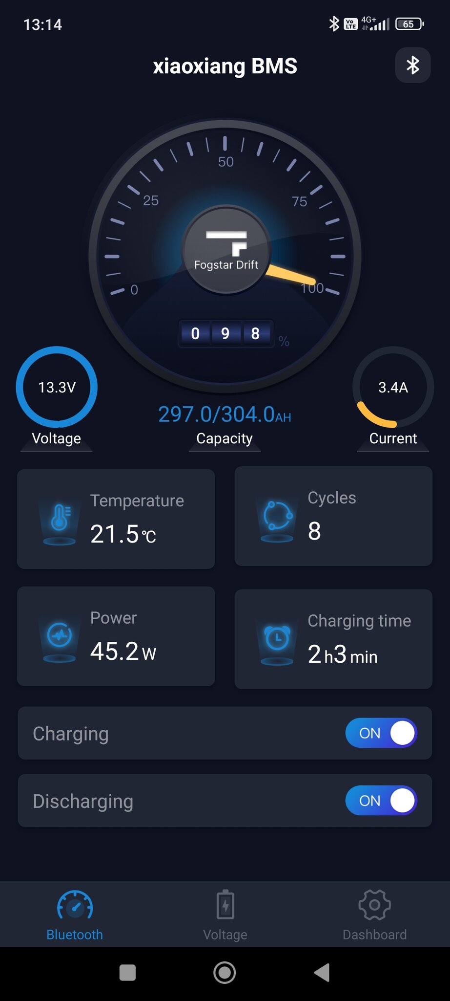

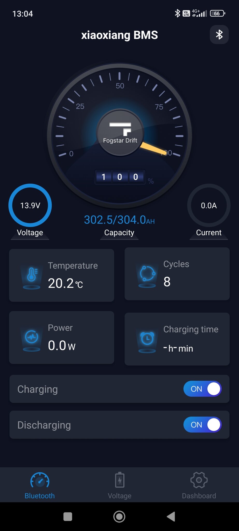

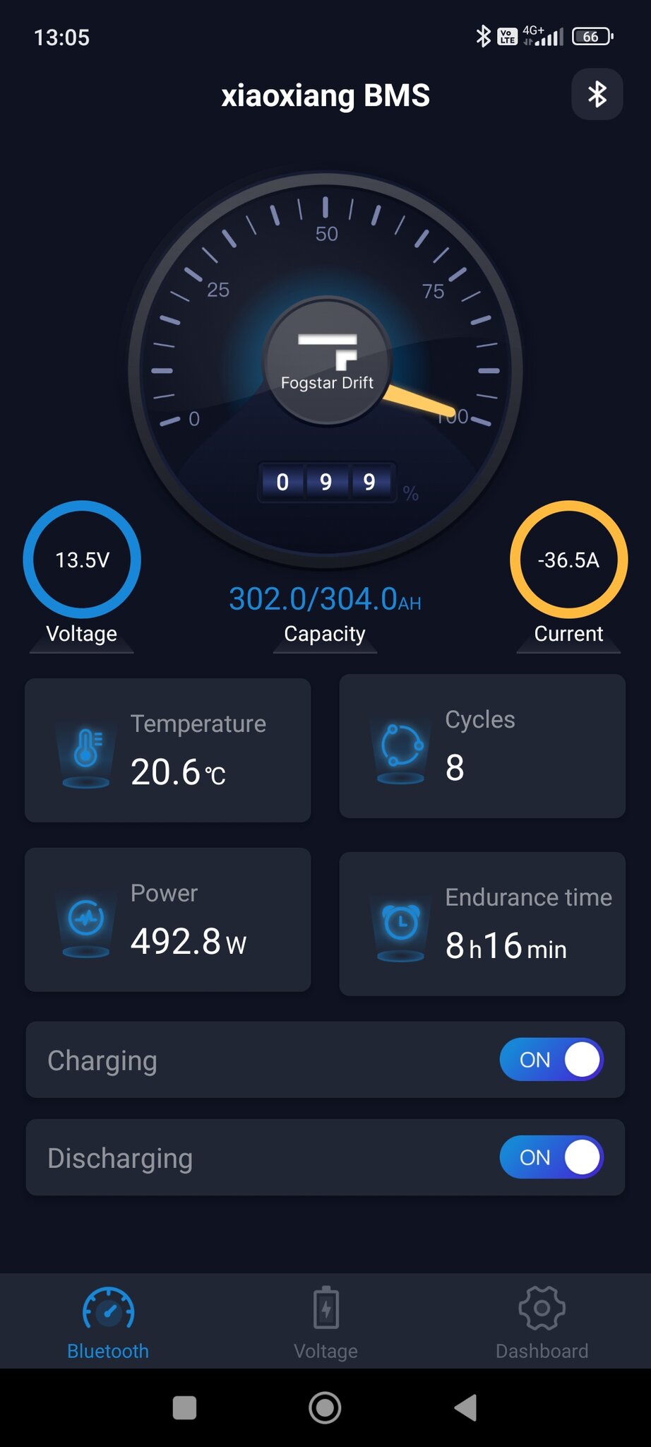

I have finally got round to testing power consumption - I didn't turn off the solar, which was delivering around 9Amps, so that needs to be considered. Allowing for inverter power I reckon you can add about 8 Amps to the current being drawn.
Without oven on
Oven set to heat bottom plate only
I set the timer for ten minutes as suggested when preheating, when finished it showed this reading on the capacity, remember at this stage the oven is off and the solar is charging the battery.
On the next screenshot I have the top and bottom heater plates on for five minutes
And finally when it had finished the next screenshot gives an idea of the total power consumption. As I mentioned, it is slightly slewed by the incoming solar, but gives an idea of total current draw.
Conclusion
- to preheat the oven it will draw around 7Ah and take 10 mins
- for one pizza after pre heat, using top and bottom heaters, it will draw around 5Ah from your battery and take about 5mins. We have previously cooked pizza from frozen and it took just over 5 mins, I assume fresh might be a lower time?
  • based on previous cooking experience for one pizza from frozen, inc preheat it will draw around 12Ah from your battery and take around 5 mins
  • for two pizzas I assume 7Ah + (5Ah X 2) so around 17Ah and I assume around 20 mins in total.
So it seems to be quite a bit less than thought, but of course I had solar coming in, so I reckon it's around 20 Ah off your starting power from your battery, prob less if the pizzas are not frozen.
