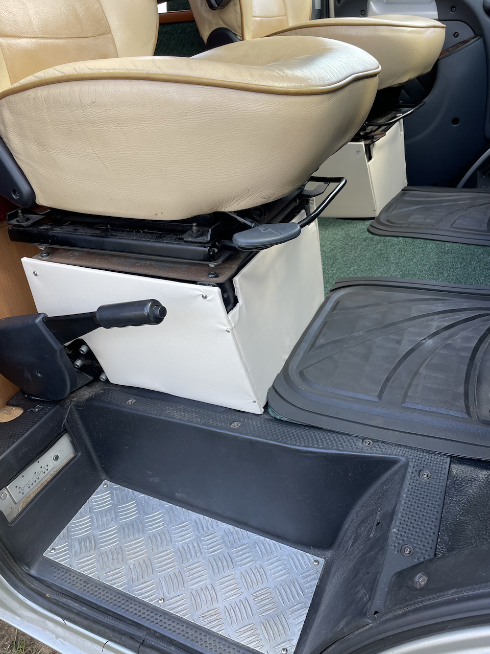

my old school handbrake doesn't foul the swivelling seat.. it's a bit of a stretch to use, . but you get used to it..
