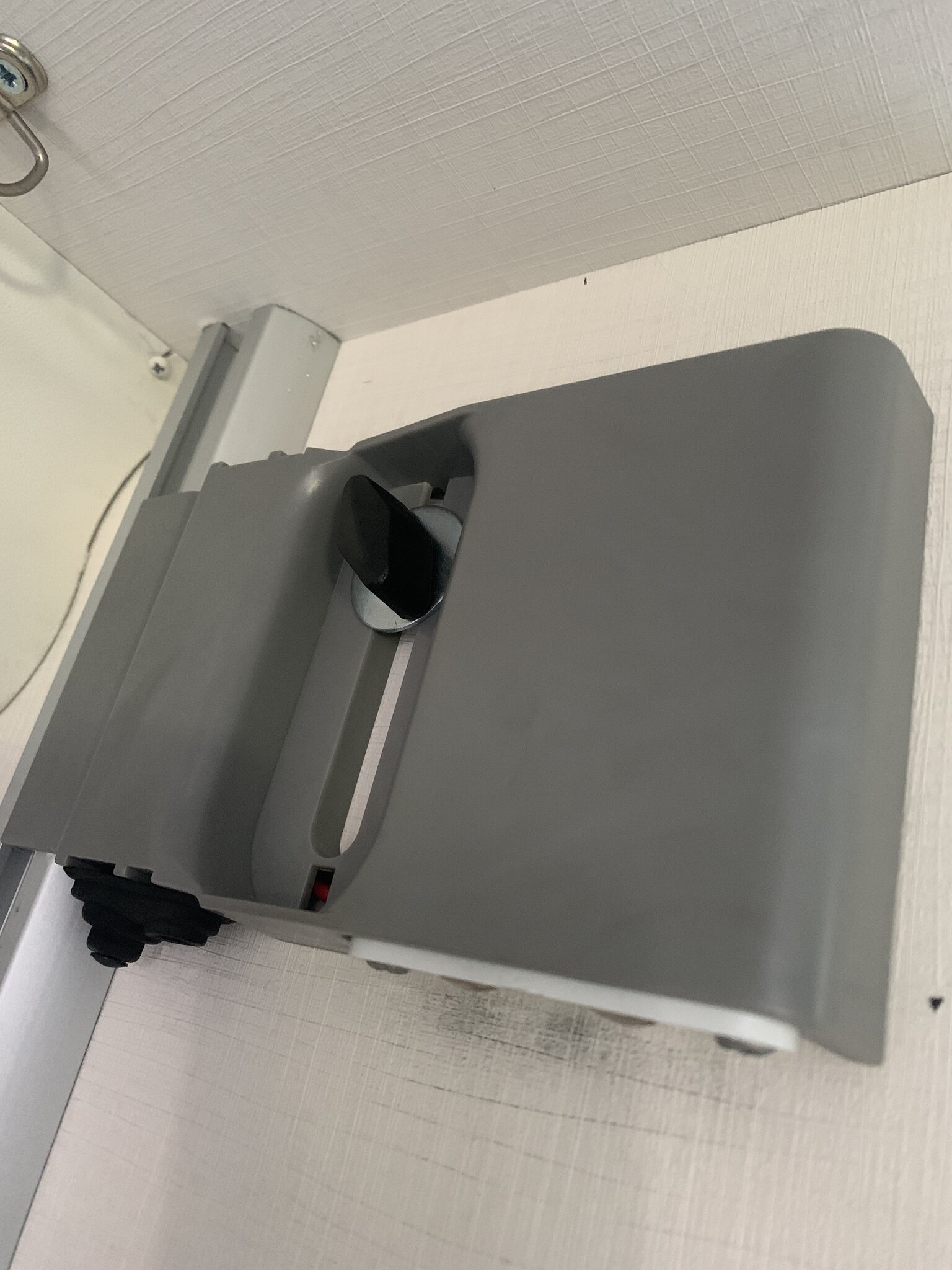

We have a Chausson Welcome 610 2019. I’ve attached photos of the switch that I think you’re referring to. We have adjusted the height up and down of the box and tried pushing it up a little when at full height but nothing seems to have worked. 🤷‍♀️

Try cleaning the contacts, the bed has two contact pins that when under pressure (bed is up) make contact with the base plate on cupboard/wall.
try clean both contact pin and base plate connectors with very fine emery/sandpaper.

The only other thing I could suggest is if you are familiar with using/have a multimeter is to check the contacts for power on the switch box you sent a picture of, there should be power at the connections.
At least this would narrow down the issue, I have had a few issues with contacts on mine.

A multimeter is the way to go. Check for power at the micro switch, if no 12v there work back to the fuse box or battery.
