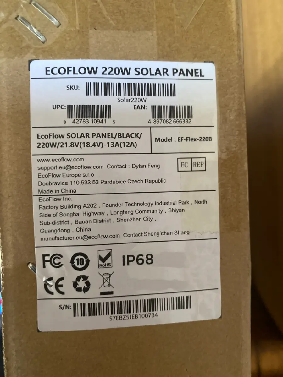

Here is our back up plan, maybe cheaper than an inverter 👍 £250black Friday deal, probably cheaper today 🙄😁
I’m keeping my eyes open for a similar deal 👍🏻👍🏻
