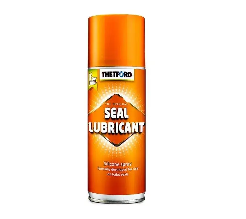

Then spray with silicone or if none available, olive oil.

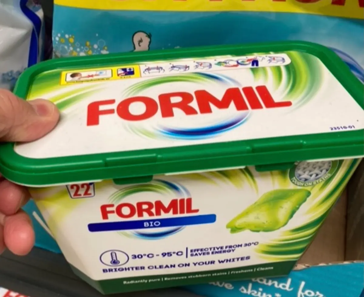

We used biotabs in our cassette and never had much of a problem with timescale etc.

I use the bio tabs as well but still get limescale buildup. Last year used a limescale remover potion(can't recall which), filled the cassette for 24 hours. Clean as a whistle.

Lube with silicon spray after…
