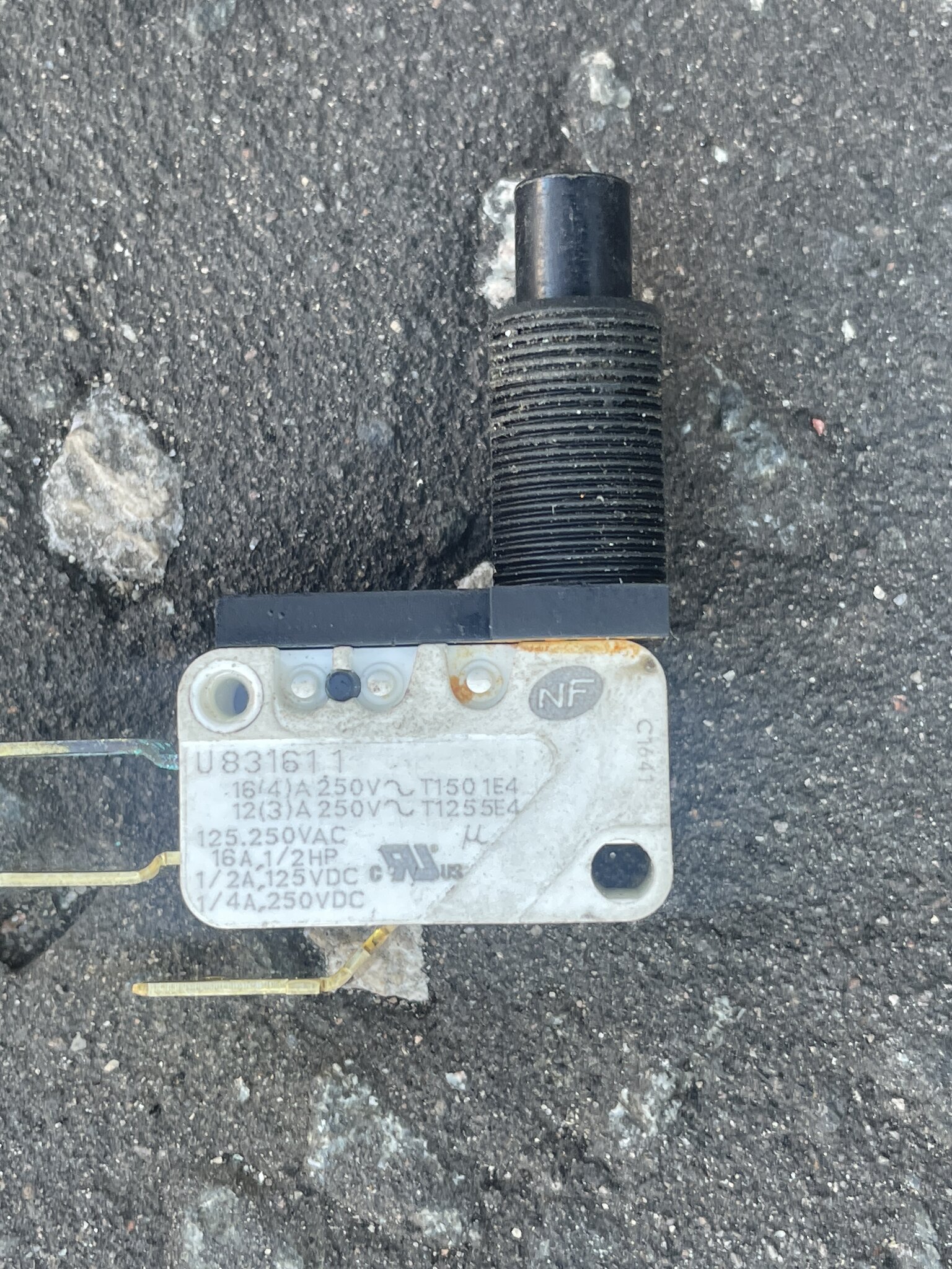

As per the thread title, the extended step warning buzzer on our ducato PVC has stopped buzzing.
Googleing suggests either a corroded earth or a sticky switch, but access looks tricky and nothing is obviously aray.
Any thoughts, tips or suggestions on what to do to remedy?

Solution2
I had the same problem last week and it was due to the waterproof rubber dome on the switch being split due to wear & tear.
The switch is mounted on the step motor cover. I couldn't find a replacement dome so bought a complete switch & just changed the domes over.

Solution
OK, it seems to be the microswitch is stuck closed.
Any ideas where to get a replacement cheaply? The microswitch p/n U831611 shows a reasonably commonthe microswitch part, but without the black piston.
I can't easily remove the black piston from the original.
The only supplier I could find was www.hillviewawnings.co.uk at £27.62 inc vat & carriage.
