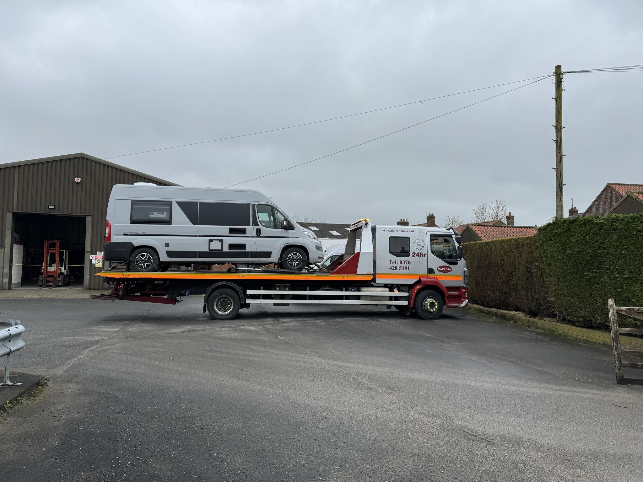

Had it 3 months, just gone into fuel saving mode ⚠️🤔🤬😂
They have fixed it apparently was the cable not adjusted / connecting correctly .
Stuck in neutral ☹️
