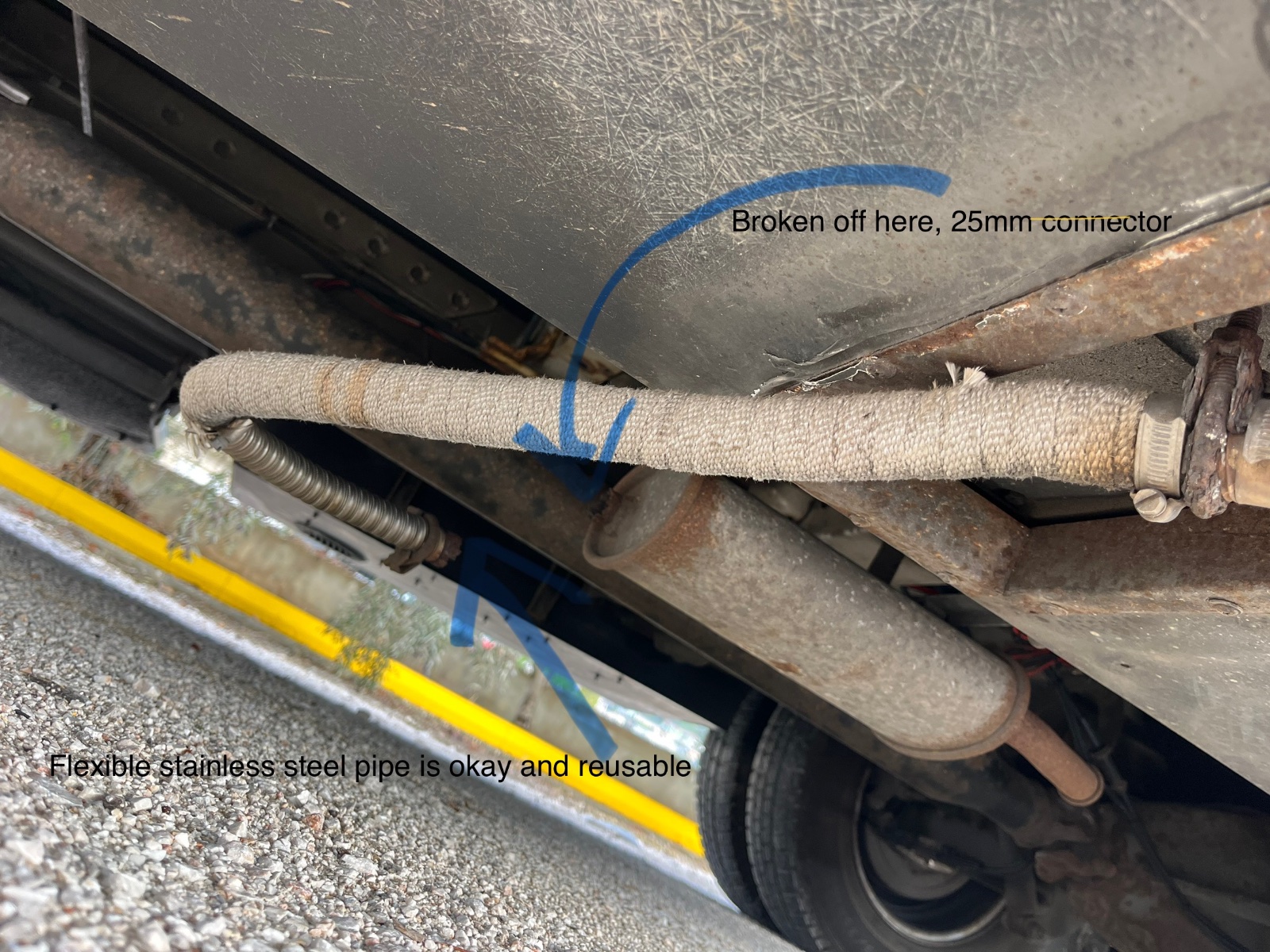

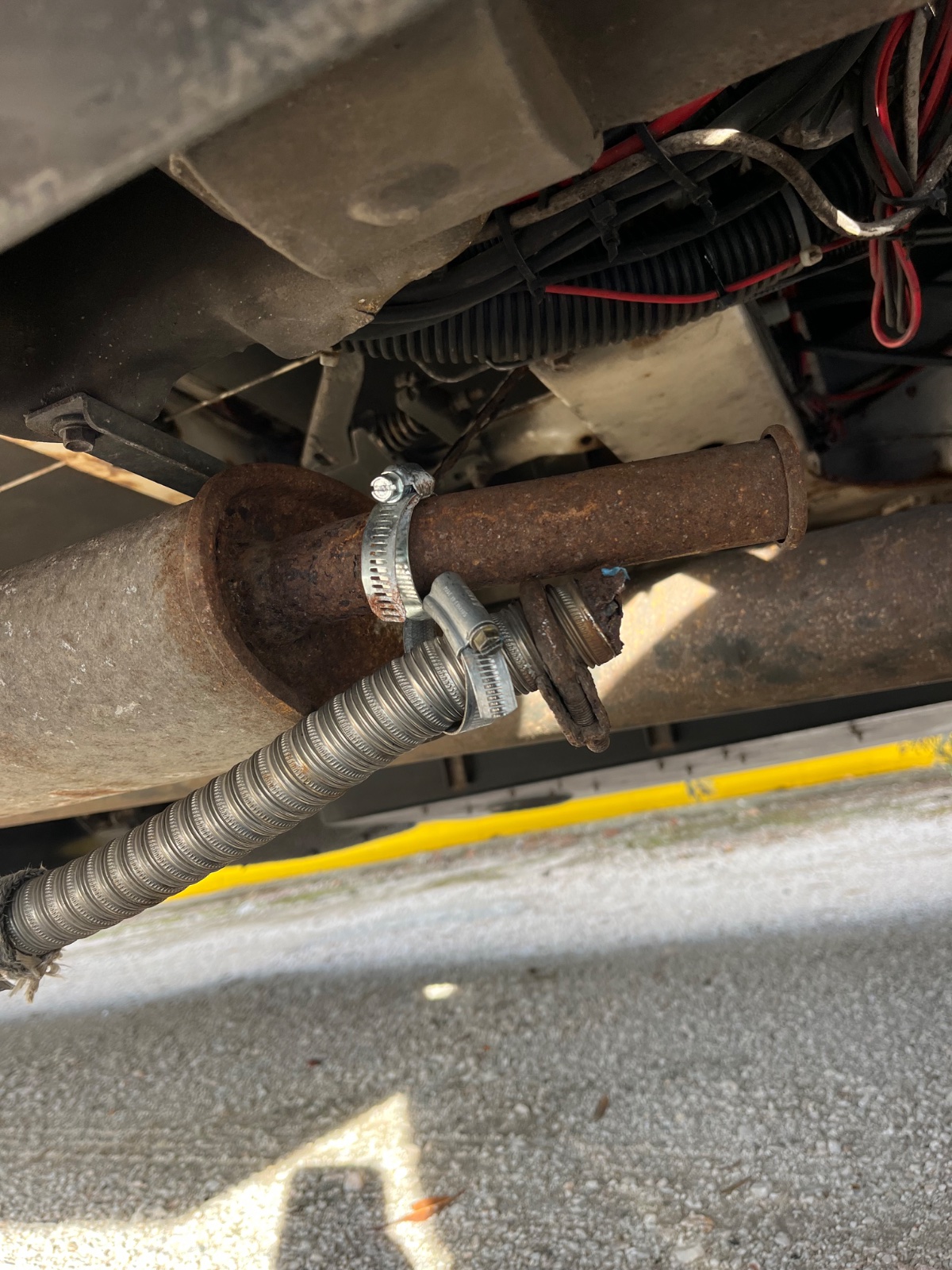

I need to replace our exhaust as the inlet connection has rusted off, it’s a 25mm connection.
Has anyone replaced the exhaust using a non standard one?
The cheapest I’ve found is €175 including postage (possibly plus duty) being despatched from Italy.
The usual UK outlets either don’t have it in stock (possibly may have some more in January) and the price is >£280!
I’ve hooked up the flexible stainless steel pipe so it doesn’t drag on the road!
I could possibly get a short length of 25mm pipe welded to the existing exhaust inlet, given that the exhaust is 14/15 years old I think I would rather replace it.
Any suggestions or alternative exhaust ideas welcome.

All the Chinese diesel heaters are 25mm exhaust so think there are a few options available.
At that price I would get it welded or get a stainless one made.
I can buy a full exhaust for the car for less money.

View attachment 978501View attachment 978502View attachment 978504
Looks very similar to mine, I think if I wanted to keep it I would look at having one made and sort a shorter run. However having had it on for 3 years and never used it, Ive bought an additional lithium and taken it off.
They do seem to rust very quickly. The pipe between the exhaust and the generator rotted on mine and it was only 2 years old. When I was replacing the pipe I did notice that the part you have issue with was extremely corroded. I think perhaps moisture sits on this section. I always say we should take it off, then winter comes and we start to use it. I should allow the lithium to discharge more, I get to around 40% and the generator goes on. We only run it when we are not near anyone such as in lay-by etc.
Martin, it’s a job on my list of things to do, not fix the exhaust, but remove the generator and repurpose the locker for more useful purposes!
I would have one made. Talk to a local fabricator as it’s easy to silence more than you have currently, which will make it more user friendly too!
Mine was rusty in the same place and pipe broke .. I cut it off at the weld and we welded a section of stainless steel 25mm pipe in place, buffed it up with the grinder and resprayed it. Good as new for 20 years old.
I wouldn't pay £175 for a replacement silencer , if mine hadn't been repairable I'd have had one custom made from stainless steel . Which would have been a lot cheaper.

At the moment we are in Greece parked alongside the ocean, no neighbours, no cars or scooters and no people. We intend to stay here for a couple of days. As the days are shorter, dry but not sunny all the time so like stewartwebr mentioned I used the generator when the lithium were around 40% soc for about an hour yesterday and the metal pipe snapped off!
No one around to object so we ran the generator today while we went out cycling for about an hour to the nearest village so we didn’t hear it either 🍿
As some of you have suggested when we get back home I’ll remove the silencer and look to get it repaired or a stainless steel replacement locally if not bonkers expensive. I think the diesel heater exhaust option also has merit if all other options fail.
Thank you for your advice and suggestions. Martin
