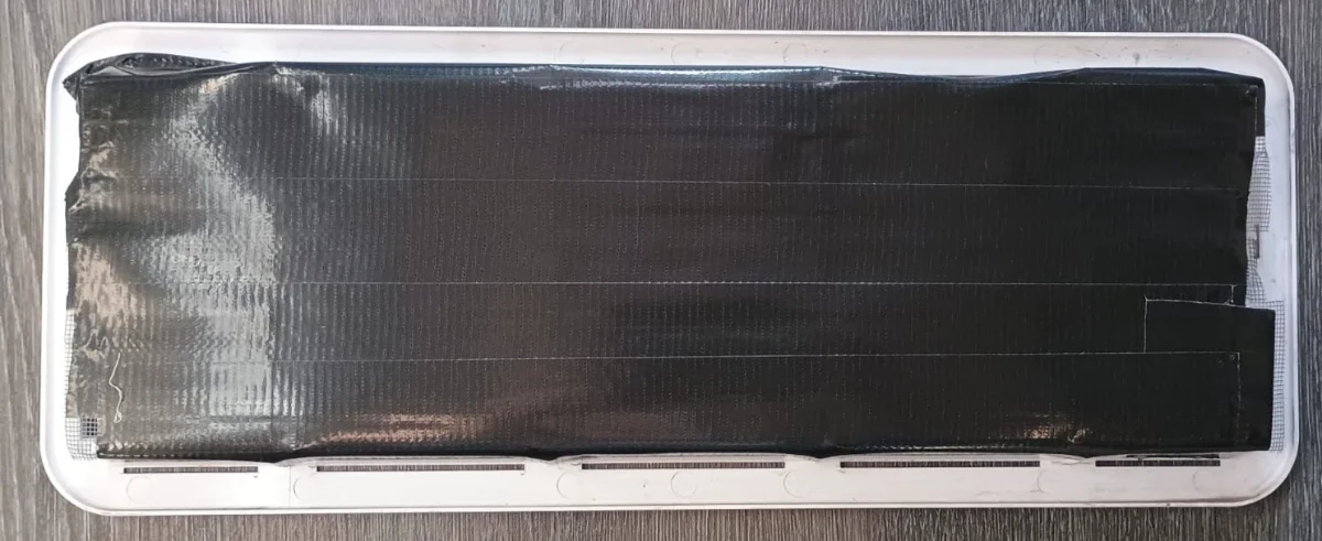

It was really windy outside, so I wondered if that was the problem. I don't have a winter vent cover so I McGuyvered the lower vent cover thus...
leaving just the bottom holes uncovered...
It lit and stayed lit. I thought I had cracked it, but it went off after fourteen minutes. I tried it again, but this time it went off after six minutes.
I took the van back to the storage yard; where it is parked there is a storage container on the nearside, so the fridge vents are sheltered from the wind. With the duct tape still on the back of the vent cover, I tried again, confident that the flame couldn't be blown out by the wind.
Sure enough, it went out after five minutes the first time, and four minutes the second time.
