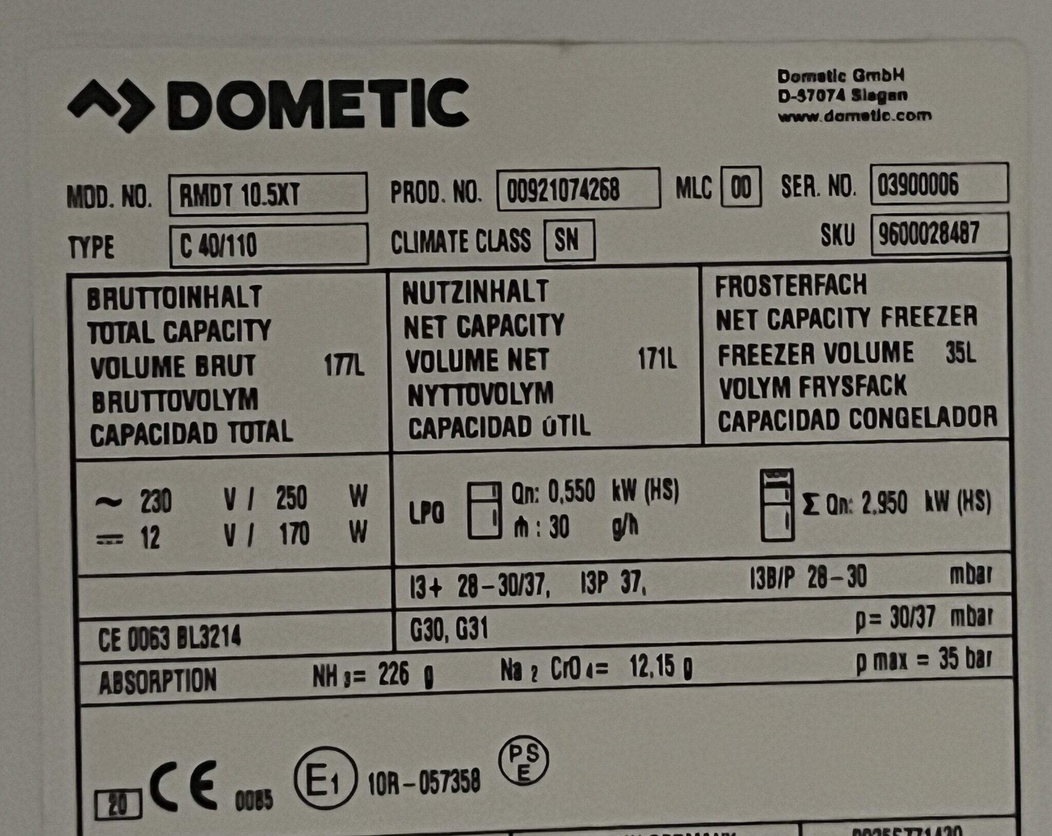

hi you more experience than me lot
We have a Dometic F/Freezer in our Rapido and the door bottom shelf has broken and needs replacing. I’m searching and getting nowhere so can anyone help me please
The bottom of the shelf has this no. 289 0726-0 by the way but no idea if this is the actual part no. As it’s the bottom one, their are 3 in total, it’s usually the deeper one to hold taller items
This is a photo of the label stuck inside the unit itself at the bottom behind the salad draw
thanks for any help offered
Al

Leisureshopdirect should be able to help. Their website is a bit awkward to use, especially on a small screen like a tablet. Don't enter the product number (00921074268) on the home page, navigate to the fridge spares section and enter it there. They have motorhome and caravan sections but I don't think it matters which you use. Once you enter the number you should be offered a list of diagrams, shelves are in the cabinet one.
