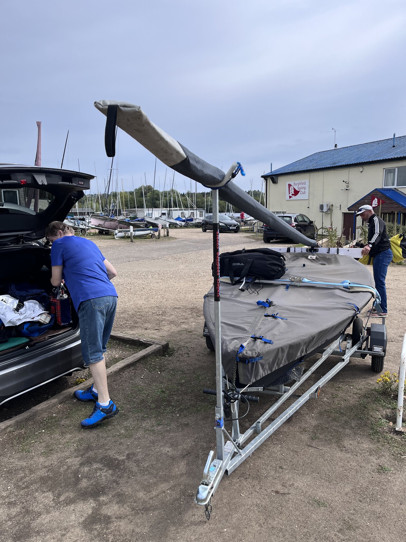

I have just taken up dinghy sailing (solo) and want to use my Motorhome (AS Nuevo) for travelling with it. I have a tow bar but think there are two restrictions to this idea.
1 the mast on the trailer sticks out a long way
2. I want to carry an e-bike as well
I was thinking about attaching the mast on the roof somehow, not sure
3. I was thinking about getting a fiamma bike rack on the back but not sure of the weight restrictions
What are your thoughts? Any examples?

Could you fit some sort of bike rack on the dingy trailer?

Why not have the mast sticking out of the back to reduce the amount it projects at the front!

I would find some way a carrying it on the roof , many people carry surf boards and canoes on their roofs.
Just find a decent set of carry brackets.

A permitted overhang of 3.05m is OK but you will need a trailer board fitted, as others have said the roof may be a better option.

Would replacing the mast stand at the front with a taller one solve the problem to avoid snagging the rear of the Motorhome. Without knowing the specifics it might then be too tall

My nieces did competitive sailing (420 class) all over Europe and parents towed the boat behind the van. I think they extended the mast rest at the front to increase the angle so it cleared the van

If you raise the angle of the mast be careful of low bridges it would be very easy to forget! I think I'd try to fit the bike in the dinghy somehow.

Did it for years with daughters 420, mast stuck out of back with extended light board, if you are not racing the solo look at buying an old mast cutting it in half and sleaving it at the join. I think r/s feva masts are done with a join. Or I could fit some masts inside motorhome through back window. Another option if the trailer is a Mersey 220 try a Mersey 275 (base) wayfarer size. Gives longer for mast and put bikes between boat and mast support. Just ideas
Worried that someone will go into the mast
I towed an 18 foot Osprey behind the van for many years and risked the overhang with flourescent markers and a red flashing cycle light. A bit risky as the carbon mast was about £2000. A friend had a Roller Team and stowed his mast on the roof
