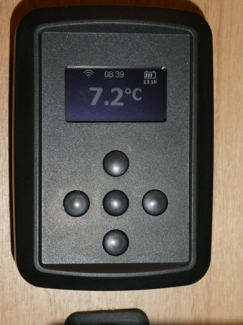

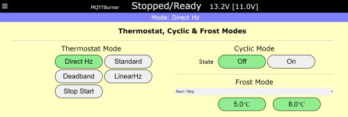

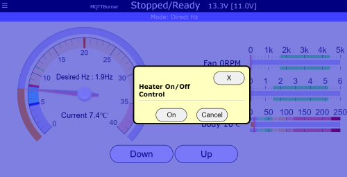

I control our Chinese diesel heater via an Afterburn controller. Not a cheap option, but I can either control our heater directly via the keypad, Bluetooth, or via a webpage on my phone or PC while away from our van. It may seem a little over the top, but by heck you can control and adjust all aspects of the heater and more. The Afterburner also has a fuel gauge, 14 timers that can be set over a 7-day period, plus a GPIO that you can program.

No wiring is needed, it replaces the standard controller by unplugging the existing one and plugging in the Afterburner.

Correct, an Afterburner controller is an easy option to achieve what you want to do plus a lot more.

You run Home Assistant on a cheap and small Raspberry Pi Zero 2 W and communicate between Home Assistant and the Afterburner via MQTT.

I have one of these, great bit of kit. Any advice on setting up the internet access via MQTT. Is there a ‘simple’ way of doing this without requiring server programming skills?
If you are a member on the Ray Jones Afterburner Facebook group, then go to "Guides" and scroll down to James Brookshaw's video on setting up Afterburner remote control via MQTT.
If you are on an Android phone then Ralf Janssen has built an Android app to walk you through setting up MQTT. You can find it in "Files"
I use a free public MQTT broker called hivemq
