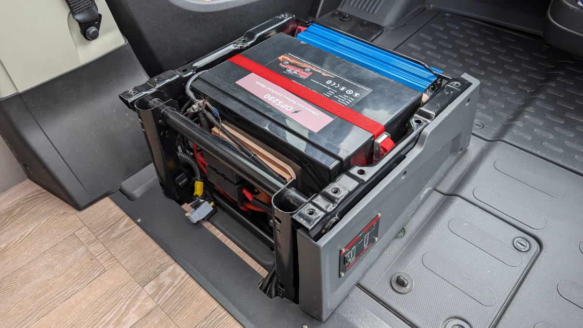

The battery needs securing, a strap works well. Depending on your space in the Ford you may be able to fit a decent size lithium on its side and strap it down. The photo shows a 280 in a Ducato seat base with room for an inverter and the fused cable connectors.

The battery needs securing, a strap works well. Depending on your space in the Ford you may be able to fit a decent size lithium on its side and strap it down. The photo shows a 280 in a Ducato seat base with room for an inverter and the fused cable connectors. View attachment 994763
Tidy tiger.
