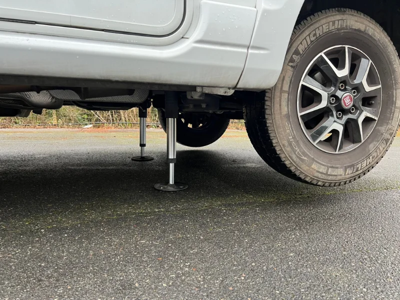

I've seen vans bigger than mine sitting on those levellers and there's a foot between the ground and the tyre .. sometimes all 4 wheels are off the ground. I've often wondered how safe that is.
Because really it's just like a jack ....without the axle stand.
Personally I'd park on a more level spot lol.

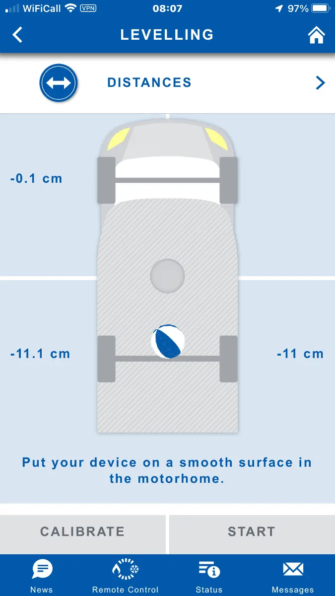

We use the free Truma app which has the Motorhome levelling option, then you can usually move the RV around a bit to find a reasonable level bit of ground to deploy the jacks.
Arthur.
Arthur.View attachment 1001229
Judging by the angle of some jacks when deployed not very. We saw one which had wooden pads under the jacks to lift it higher with all 4 wheels off the ground, no idea why ... maybe just liked to be higher than everyone else. 😄
We saw one the other day and the rams were very thin, they certainly didn't look sturdy enough for the large MH they were fitted to and which had the front wheels in mid air.
Us too or use our ramps, at least with them the wheels are still supported.

While in Portugal in November a big Concorde turned up, they levelled using the rams then the guy got out and put chocks under the front wheels that were about 6 inches off the ground. I did wonder why he was doing this now I know 😂
With the E&P system fitted by SAP the rams are substantial (avoided the schoolboy joke). On an uneven pitch occasionally a wheel will be clear of the ground. Note that the van has had uprated front suspension as well as rear so sits level on level ground
