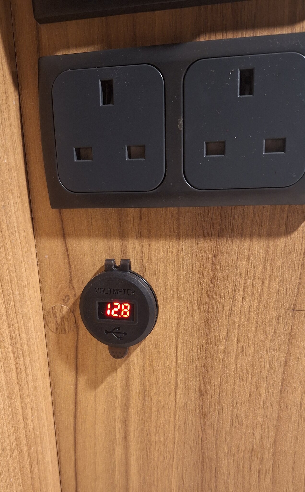

I favoured those at first as there were no decent quality usb sockets available, they were all plastic low powered and failed regularly. The new generation of twin QC3 sockets are very good though, and I think much neater looking. I always strive for a factory fitted look 😎
Also they don't wobble outwards and lose power sometimes.
View attachment 874766View attachment 874767View attachment 874765
Your set up look good, what make is this please and is it just a case of positive and earth straight from the battery, with an inline fuse
