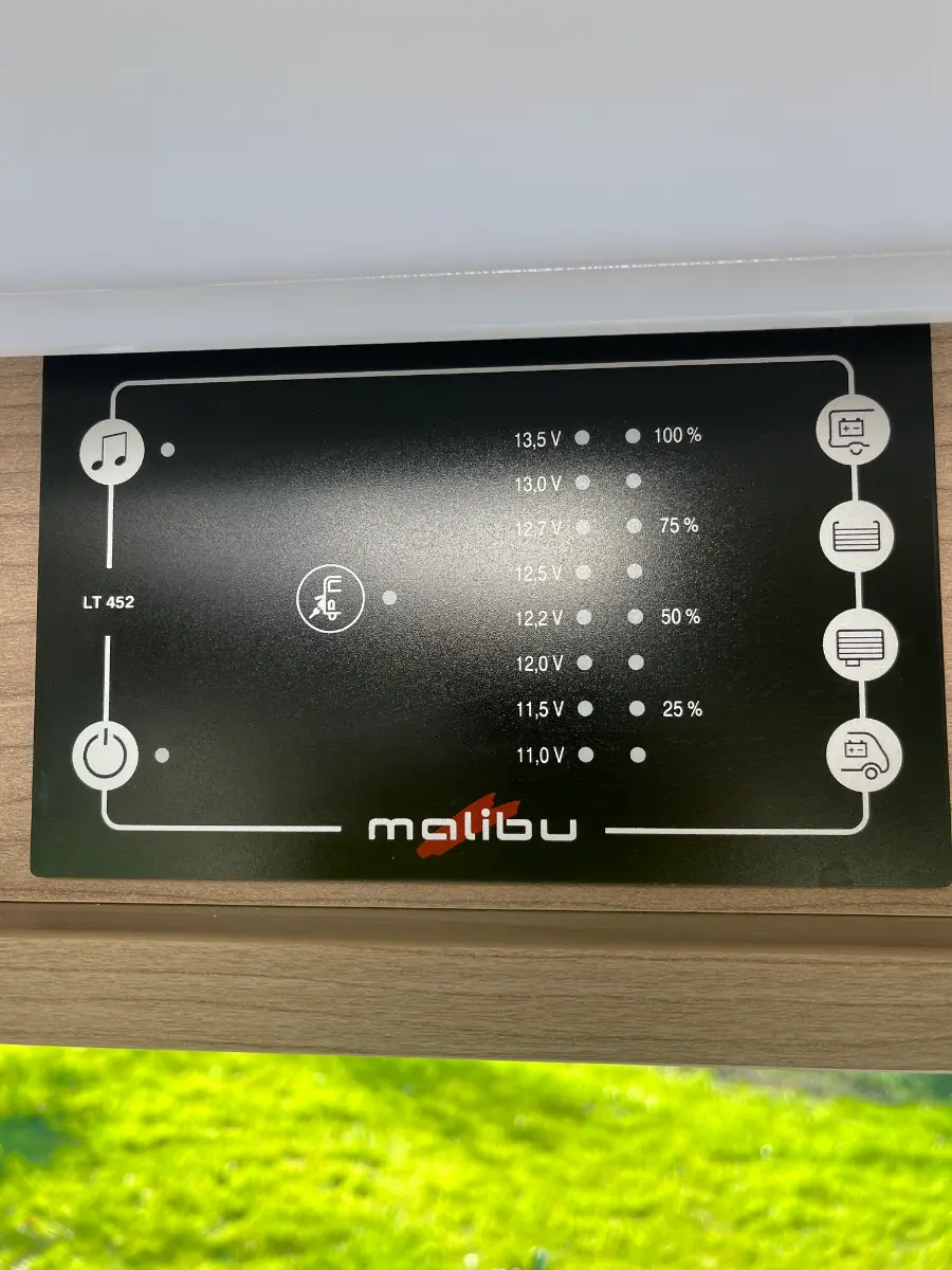

I finally got my van back last week after nearly 3 months waiting for the replacement steering rack. Good news - no steering issues now. Bad News is that the control panel is now not working, the panel is completely dead and I have no power to the any of the water systems. The lights and entrance step are working ok and I have put the van on charge. I have checked trip switch and all the fuses I can think of. Whilst the van was at the garage I had a nagging feeling that I had left the control panel switched on, could this have perhaps have burnt something out ? I am absolutely hopeless with electrics so am thinking of taking it to local repairers, but before doing that I'm wandering if there is a simple fix ? Any help much appreciated.

I think your panel is a Schaudt LT452
Very similar to ours - we can disconnect our panel from Electrblok on Block 6 -
Might be possible that the panel is not dead -
When you turn the panel on - you will probably get the indicator lamp showing it is on - It is possible this lamp is not working - but is still powering up the panel OK
Ours had this fault and could not be repaired by Apuljak - new one required = try turning it on normally and see if everything is working ok -- possibly media indicator lamp on the panel will light up -? showing panel is on. Hope this might help you diagnose the fault
