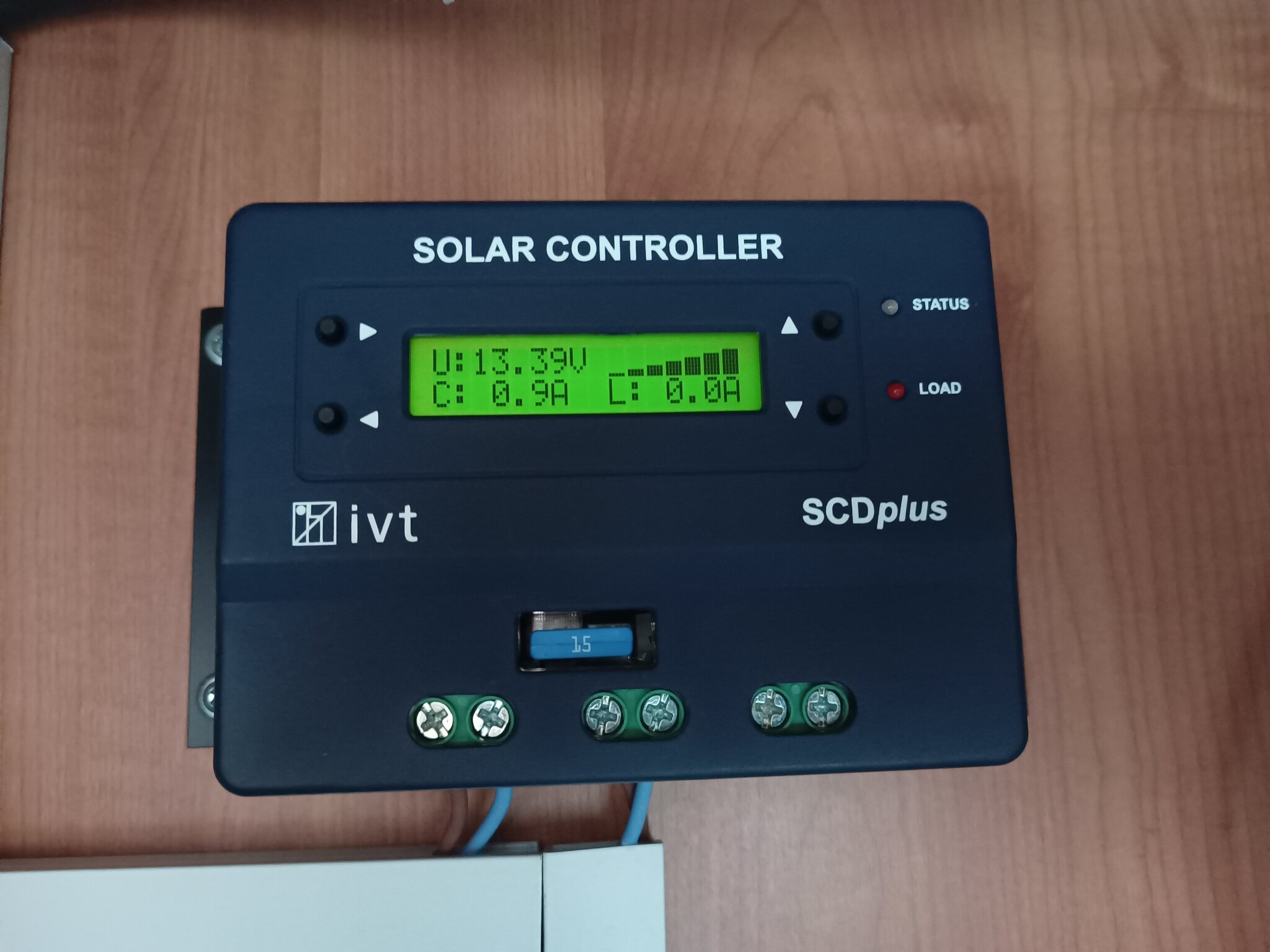

BTW, my solar controller is an ivt SCDplus.
Your solar controller is a PWM unit, MPPT solar controllers are around 30% more efficient at harvesting.
I know nothing about that solar controller. It sounds quite fancy :) will you be wanting to add more panels to the roof? if so , even if the solar is lithium compatible, it may not be powerful enough (just an observation to maybe come back?
Would an MPPT installation be as easy as swapping one for the other using existing wiring connections?

Would an MPPT installation be as easy as swapping one for the other using existing wiring connections?View attachment 700665
Yes it would be a straight swap.
I don't know how much solar you have but those cables look a bit on the small side. Also where is the controller mounted in relation to the batteries?
Controller in overhead cupboard near other electrics. Batteries under seat below that cupboard.
It is best to have the controller near to the batteries if you are leaving up in the cupboard you need to increase the cable size if you only have 200 watts of panels 6 mm sq cable should be OK.
Running cables from the top cupboard to the underseat Battery location on an Autotrail is typically a total nightmare. I can pretty well guarantee that if someone is not happy fitting batteries, that cable rework is a task too big unless they run them on the surface in trunking (which IS doable but looks a bit naff).
The Sargent Units will generally take upto 150W solar and is located almost certainly close to the controller so I would think that is how it is wired up. Not ideal, but usuable. A swap to an MPPT controller is for sure a good thing to do and can be done using the same (admittedly pretty poor) cabling.
Go bigger than 150W and you would need to bypass the Sargent and go direct to the battery with the controller output.
