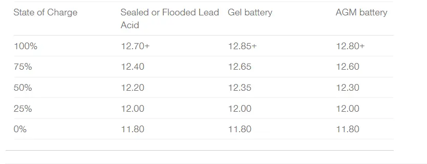

To do a discharge test:-
First charge the battery fully and leave it to settle for an hour then:-
Disconnect all charging methods.
For example if it's a 100a/h battery load it with a 5 amp load and run for 5 hours, this will represent a 25% discharge. (adjust load/time to suit the size of the battery)
Disconnect the load and leave to stand for at least 30 min then measure the voltage.
Repeat the test and you will have discharged the battery to 50%.
You can repeat again then it will be 75% discharged.
