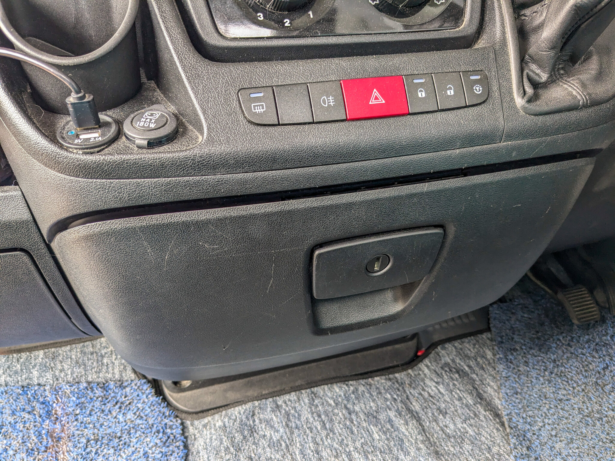

We collected our Murvi in March 2013 so I guess the base vehicle was made in 2012. From memory the cab air filter has only been changed once. This filter in theory filters out pollen and dust from the air been blown into the cab.
It should be an easy filter to change, it is supposed to be behind this. (Scratches on the flap are an optional extra. :) )

Numerous YouTube videos tell you what to do. First off, open the flap/drawer or whatever it's called and remove (with a T20 Torx screwdriver) the three screws circled in red, or in my case remove only two as someone had already pinched the middle one. :)
