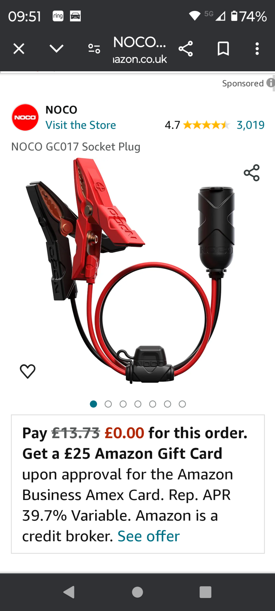

Compressor can pull too many amps - you are best getting quality gauge extension.
I have chunky croc clips to 12v socket stored next to leisure battery.
I would never use crock clips in a van, dangerous things to easy to get a spark and end up with a fire.
Tend to agree with you... long term.
But surely it would be safer to use croc clips straight onto battery short term to use air compressor than plug said air compressor into an inadequate 12v socket..
Just my thoughts..
