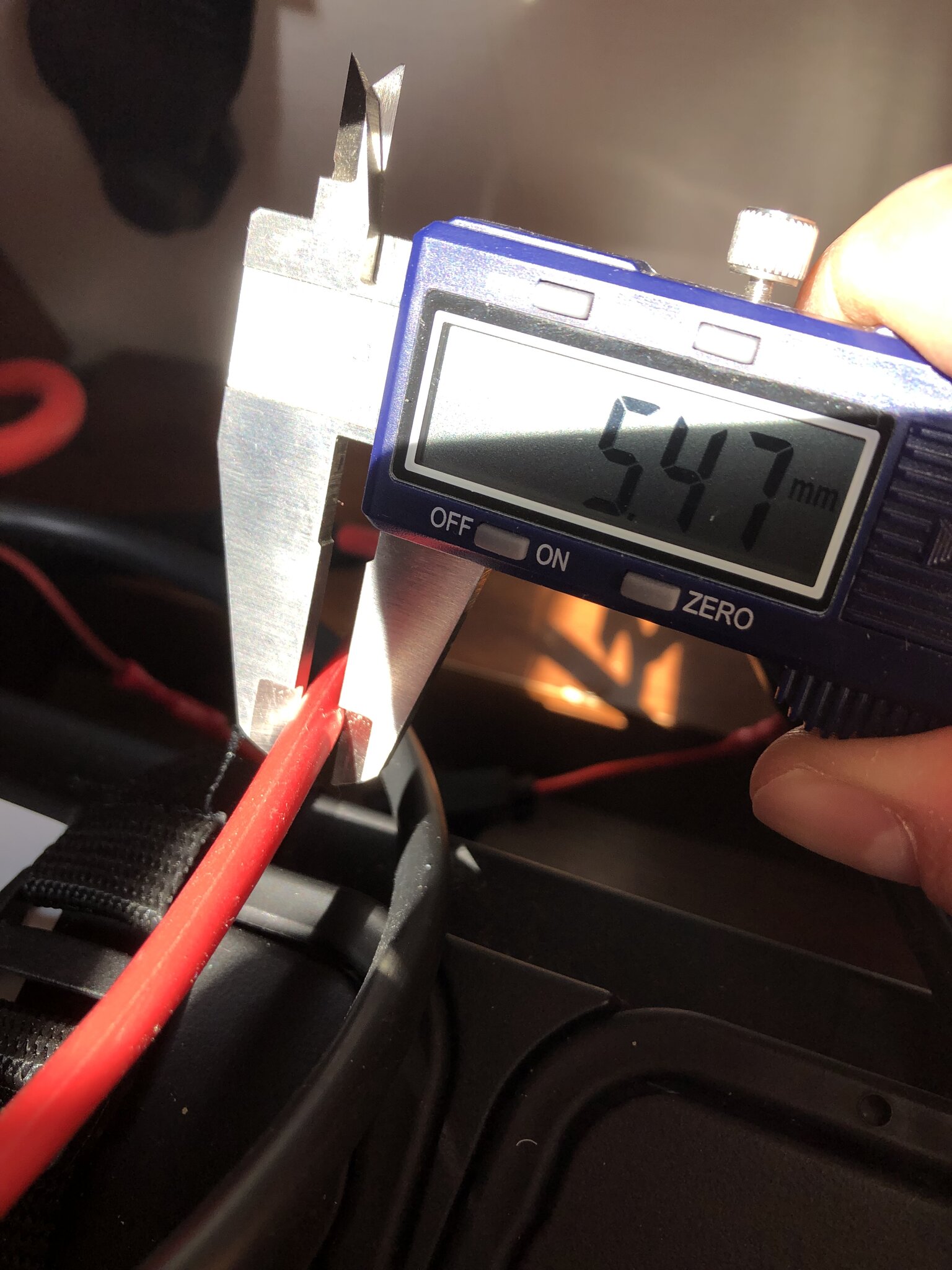

As far as I can see the cable size to the leisure battery looks like 8.5mm thin wall.
It’s pretty much impossible to trace the route of the cable but I’m estimating it’s less than 5m from the gubbins at the back to the battery.
Given that the battery path to ground should be considerably shorter then based on the one way trip distance at 14v charging 30A should be ok with < 3 % voltage drop.
